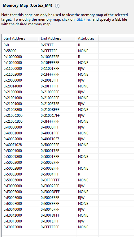

we are developing an application based on the ble5_simple_peripheral_oad_offchip_cc26x2r1lp example project. It works fine, if loaded with the debugger, but it won't restart after a power cycle.
I'm loading the BIM first and afterwards the app. With first test on a CC2650 this procedure worked. But for the CC2642, I'm probably missing one small but important step. In the build settings, the TI CC2652 is selected. Selecting the correct chip results in the same compiler errors as already experienced by Joshua Meyer in https://e2e.ti.com/support/wireless_connectivity/bluetooth_low_energy/f/538/t/657834?CC2642R-Problems-with-XDC-Configuro . Deriving from https://e2e.ti.com/support/wireless_connectivity/bluetooth_low_energy/f/538/t/404236 Question "What is the difference between CC2650 & CC2640? How do I move from CC2650 to CC2640 or different package sizes?", this should not be an issue (at least for the CC26X0 series).
I hope someone can give me a hint, where to take a deeper look.

  • Matthias,
    Did you make any adjustments to the BIM? This also could be an issue with your vector table/linker command file as well. Maybe if you provided a memory map image as well that would be helpful to see how you are allocating your memory.

    The BIM is the original as loaded with the example project. The command file is the bim_cc26x2_cc13x2.cmd. I hope that the memory map is helpful.
