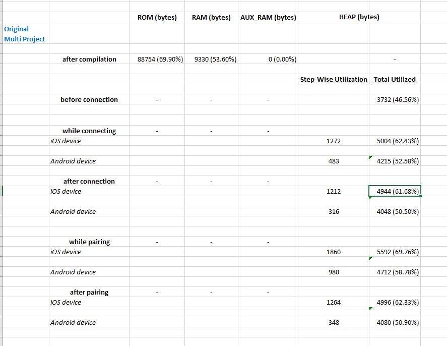

  • Sean,
    Your detailed explanation on how to estimate heap utilisation was very useful. We were able to log the heap usage metrics for several central devices, when they would connect to our peripheral device. The heap usage at various instances of connection and pairing could be found out using the methods you described above.
    To have a comparison for our statistics we also profiled the original "Multi_Role" example as an peripheral.
    The heap usages were such for an iOS device:
    1. 3732bytes out of 8016bytes before any connection
    2. 4944bytes out of 8016bytes after single connection
    and so on... (refer excel sheet excerpt for details)
    We wanted to analyse the distribution of the used heap (like MTU&PDU related usage, services&char. related usage etc.) at various instances (like before connection, after connections, etc.).

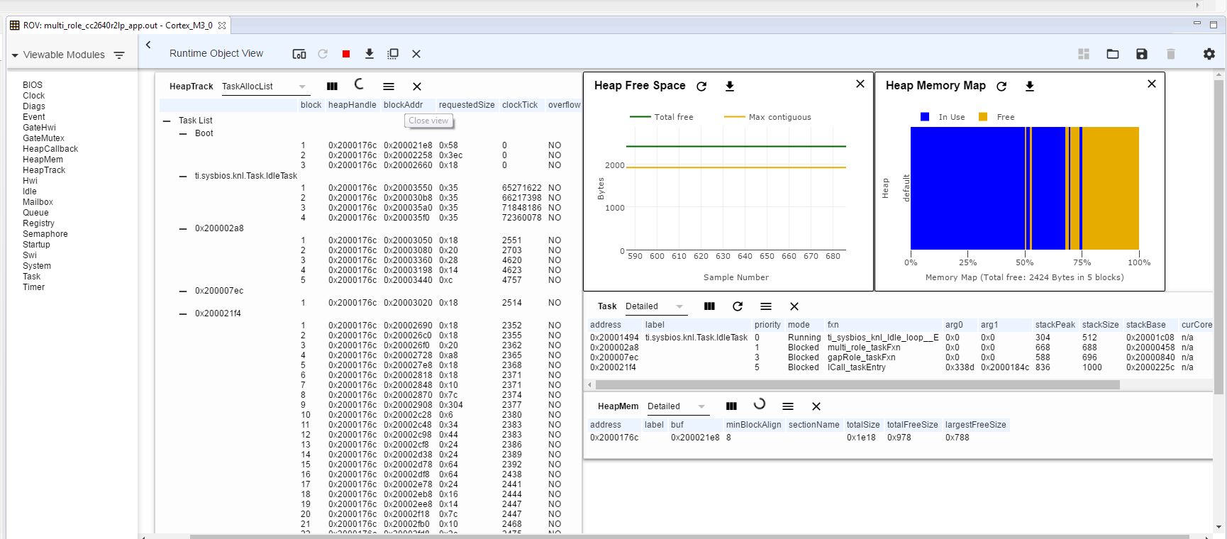

    For this we tried using the ROV debug plugin, on the original "Multi_Role" example as an peripheral, but, although the heap usage displayed was well bifurcated but it didn't show for what purpose that heap was being utilized. Example: in below image the  distributed heap utilization for iCall_taskEntry  (0x20002114) is provided but we don't come to know exactly for what these heap uses are happening.
    Is it possible to get such detailed information regarding the heap utilization?
    We are seeking these answers so that we can theoretically estimate the heap use for a particular type of connection and also curb/reduce the heap usage if possible.

  • Hi Amod,
    Apologies in the delay while responding.
    Thank you for the detailed summary an investigation.
    I have reviewed your second inquiry about the heap. All allocations that originate from task handle associated with iCall_taskEntry are related to the BLE-Stack. These are allocations that the stack has done to perform core functionality of the stack.
    Unfortunately, there is no way to know much else about these allocations.
    At this time, the stack does not have a mechanism for logging where each allocation came from.
    However, the best estimate that we can provide is to collect and dump these metrics before each operation/command to the stack to understand how much heap this uses. Of course, this is not an exact measure interrupts/preemption can always occur between measurements, but it should give you a pretty good picture of what operations are consuming heap.
