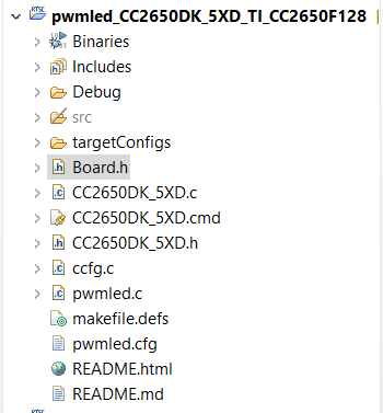

    So i opened up the CC2650DK_5XD.h and CC2650DK_5XD.c in the project (as seen in the following pic)

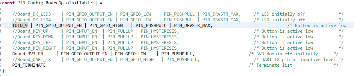

    and i changed the code in CC2650DK_5XD.c as follows (commenting all the pins except the LED pin where i have my LED attached) -

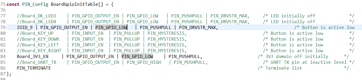

    But in this case the LED didn't even light up. So i changed it to below (basically changing PIN_GPIO_LOW to PIN_GPIO_HIGH) and the LED lit up however it didn't blink like its supposed to because of the GPIO_toggle functions i have used in the RTOS task-
    Are these the correct edits? It seems like its following only the initialization part, why is it not able to toggle the LED? Any idea why the LED is still NOT blinking using the GPIO driver?
  • Hi Shantam,
    What you are changing is the initial PIN configuration performed during the general board initialization. Note that this is a PIN driver struct and not related to the GPIO drive which you aim to use, you should be looking for the "GPIO_PinConfig" structure.
    Also note that in the CC2650DK_5XD.h file, the "**_**_GPIOName" structure need to have entries that match with the corresponding index in the "GPIO_PinConfig" structure. For example if you LED is the first entry in the "GPIO_PinConfig" structure, the first entry in "**_**_GPIOName" should be for this GPIO. The enum is what you use to address the pin later in the API as this should correspond to the index in the "GPIO_PinConfig" structure.
