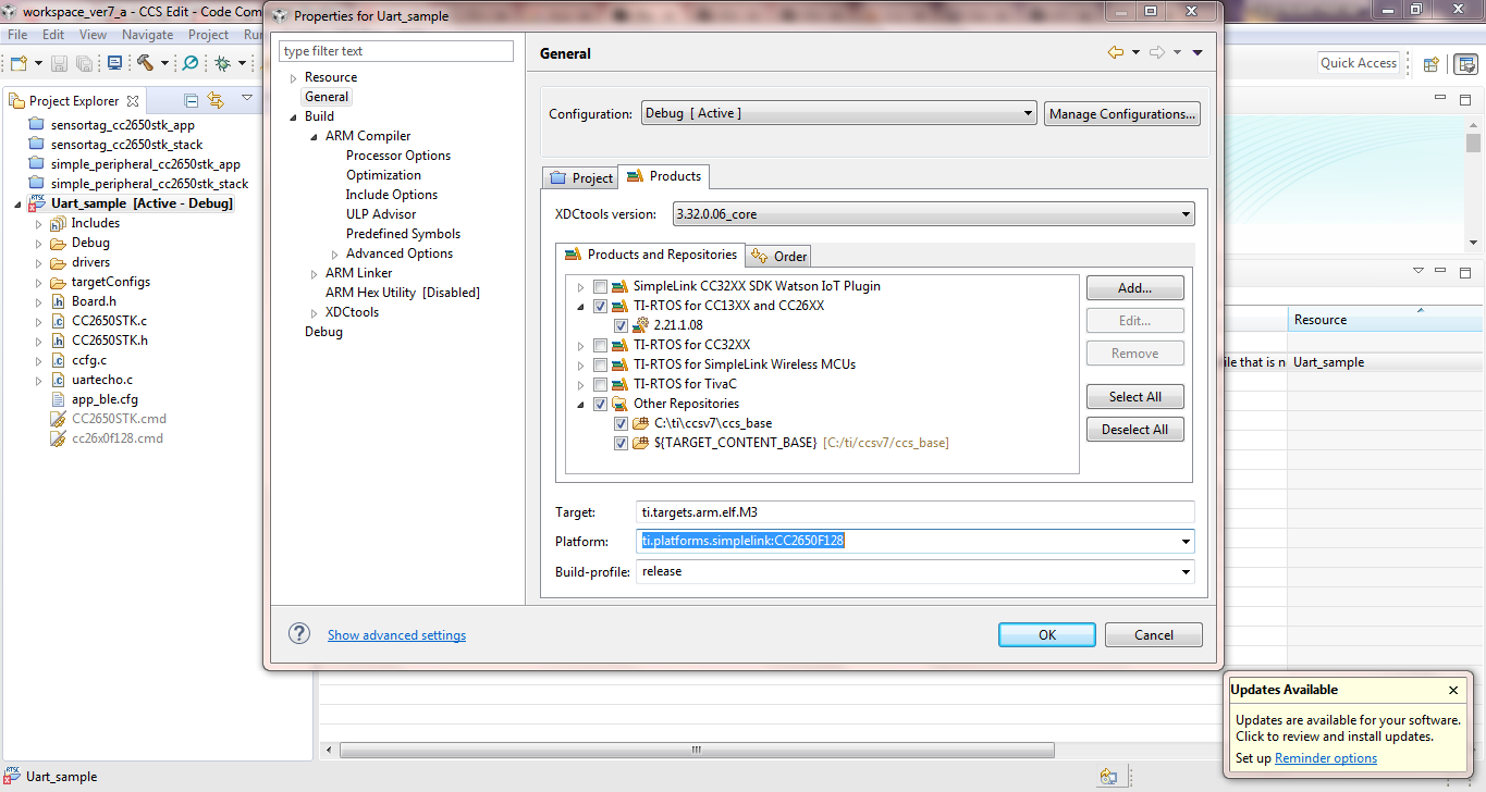

  • In your project settings, what variant is your project set to build to? It looks like you have a few missing files and defines. I suggest you work with the uart_echo example and build your code off of that project instead of creating your own project from scratch.
  • Hii Evan wakefield,
    What does it mean ??Which variant you are asking ??
    I tried to work UART_echo example but if  I am including SENSORTAG_APP project then it is not writing on the console at all.And if I am including UART_echo example as a project then import options throwing that it is not ccs project because ccs project files are not there .That why i create a new project .But since i missing some of the configuration i am unable to resolve it.
    Can i get some tutorials to how to create a new project for cc2650stk sensortag from scatch,then that is better for me.Then i get know where i am doing mistakes.Please let me know.

  • Devendra,
    to the variant:
    Go to properties> General > Variant > confirm that you are using the right device (CC2650F128).
    What do you mean if you include the Sensortag app project? Are you trying to merge the two projects together?
    We do not recommend that you create a new sensortag project from scratch as there are too many interdependencys. We recommend you either start with sensortag or simple_peripheral or one of the other sample applications. In the docs/ folder of the ble sdk 2.2.2, you can reference the SWRU293_CC2640_BLE_Software Developers Guide for more information.
