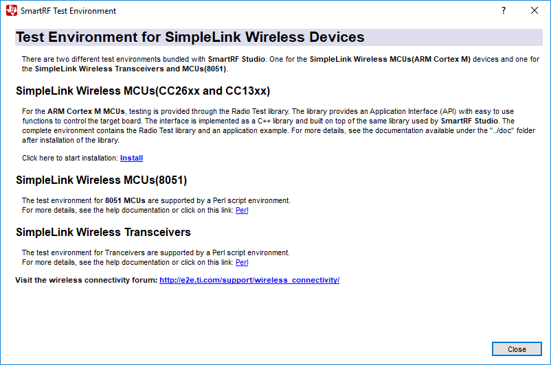

    I am recently testing on SmartRF.
    Is the source code of the firmware download from SmartRF to CC2640R2 LaunchPad is open?
    If we like to development our custom PC software with similar feature of SmartRF, what is the quickest way?

  • From SmartRF Studio you can find the following:
    Siri

    With these configuration, I can send and receive packets up to payload sizes 255 bytes successfully.
    Please kindly advice on my following questions. Thank you.
    1. I tried to receive data by SmartRF with the address set to the same as syncword of TX side and whitening option unchecked.
    But it seems it didn't work. If I am using the BLE PHY correctly I would be able to do this. Is my understanding is correct?
    2. I try to enable the settings of pOverrides2Mbps other than pOverrides1Mbps but it seems it didn't works properly. Would you mind to provide the reference code of that?
  • 1) I am not familiar with BLE so unfortunately I do not know if you should be able to receive the packets using the API used in STudio. I tried, but was not able to get it working either. I guess that you will need to use your own SW on both the RX and the TX side.
    There will be support for prop mode for CC2640R2 in the next release of SmartRF Studio (in a couple of weeks, I think). It will support 100 and 250 kbps.
    To run the 2 mbps settings exported from Studio you need to use the high speed API and not the prop API.
    The HS API is used in the PER test.
    BR
    Siri
