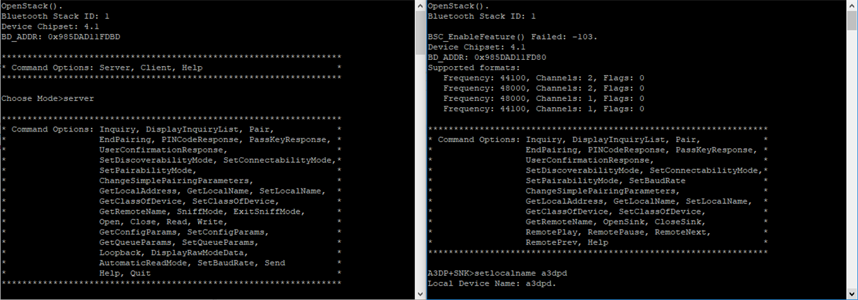

Hi TI community,
I am trying to run simple BT demo according to: http://processors.wiki.ti.com/index.php/CC256x_MSP430_TI_Bluetooth_Stack#Demos
I managed to establish connection via Putty as shown below (two separete demos: SPP and A3DP):
Unfortunately I'm unable to detect MSP from any BT device. I have two MSP-EXP430F5438 boards with CC256XCQFN-EM modules and cannot discover neither of them.
On the other hand, MSPs are able to list BT devices without a problem, but apperently not vice versa.
Sometimes one of the boards shows up for short period of time, which enables initialization of pairing procedure, but disappears before i can pair the devices.
Details:
  • 2x MSP-EXP430F5438
  • 2x CC256XCQFN-EM
  • CCS6
  • compiler: TI v4.4.8
  • output: legacy OFF
  • using "__SUPPORT_CC256XB_PATCH__"
Any suggestions how to fix this issue or what could cause this behaviour?
