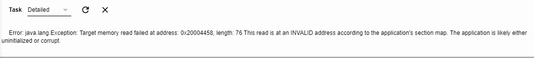

When running the SimplePeripheral example for the CC26x2 Launchpad, the Code Composer Studio ROV tool gives an exception when trying to view Tasks (see below).

    Unfortunately this did not resolve the customer's issue.  See customer response below.  Any ideas?
    Mark
    I am using ROV2. (The menu option selected is Runtime Object View and not ROV Classic.) I don’t think this is a timeout issue which appears to be what is described in the thread.
    If I step through the code, the exception first occurs in main() during the ICall_CreateRemoteTasks function. After running it again this morning, the exception is shown below along with the data in memory at the location.
