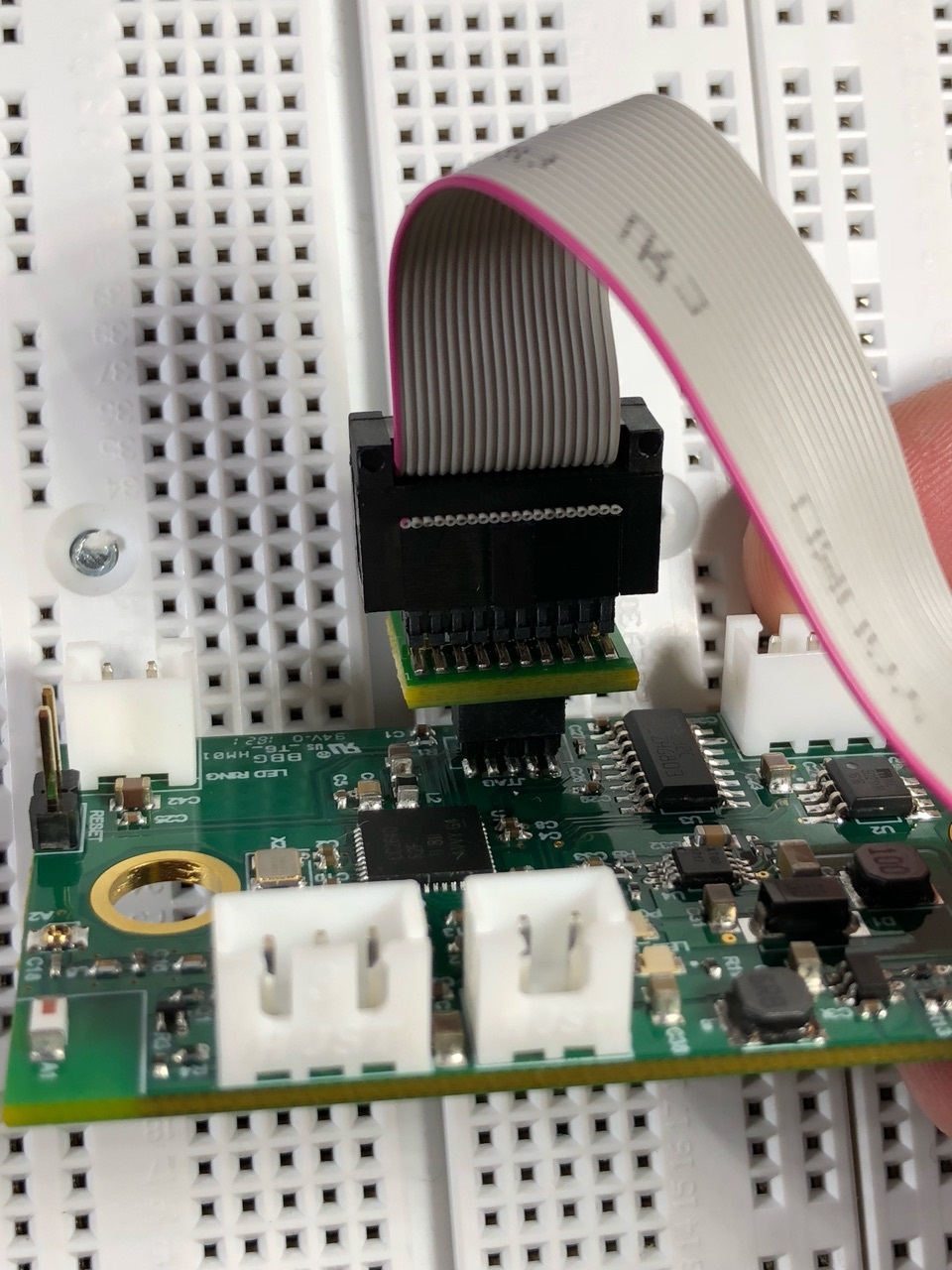

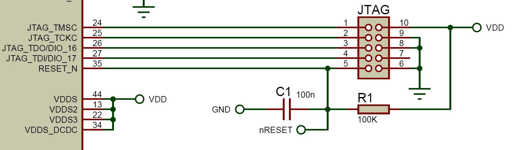

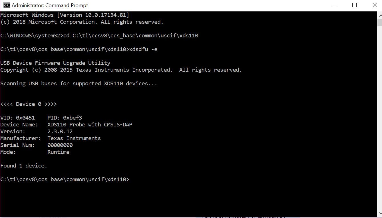

I am attempting to interface with a CC2640R2FRGZT that is on-chip and I have attempted to use both the XDS110 and XDS200 to debug. Everything is connected properly and yet I keep getting error -267.
I've tried different computers, debuggers, moving the pinout to different angles and I'm completely stumped. I also know that CCS is updated and that my test LAUNCHXL-CC2640R2 is connecting as expected.
Some help would be greatly appreciated!
