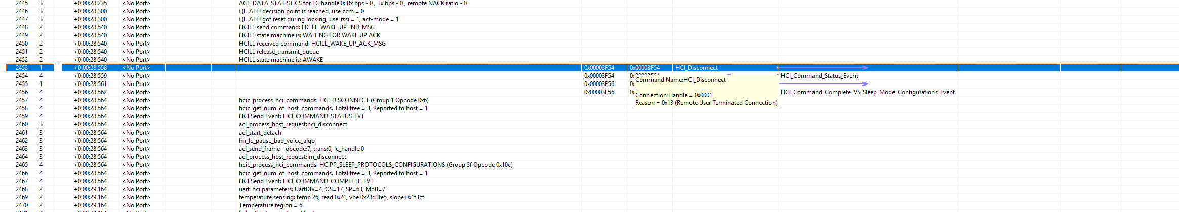

  • Hi Vihang,
    A little update on this matter:
    From another of my post on this forum, Saurabh said that my logs were incomplete. So I logged, with right parameters this time, a disconnection from user on the remote side (see attached files) and studied the logs.
    As I can see, there is a HCI_Disconnect command send from the host to the device with Reason 0x13 (Remote User Terminated Connection). It is this information that I would like to get on my microcontroller. Because my code do not send intentionally the HCI_Disconnect command, I suspect that is the library SS1BTHFR that is doing it.
    I registered and added the HCI_Event_Callback in the idea of retrieving a etDisconnection_Complete_Event. Unfortunately, it never come.

  • Alain,
    I see some unusual behavior in these logs. While it does look like the host stack is sending HCI_Disconnect command to the CC256xB, the chip is being reset before it can send the Disconnection_Complete_Event for this HCI_Disconnect.
    - #2453 Host sends HCI_Disconnect command with reason 0x13.
    - #2454 Controller sends the HCI_Command_Status_Event for this command.
    - #2455 The host sends HCI_VS_Sleep_Mode_Configurations command to the controller. This would never be sent out by the stack or the profile itself unless specifically programmed in the application. <- Please check if you application is doing this.
    - # 2468 Before the CC256x controller can disconnect the connection and send the corresponding HCI_Disconnection_Complete_Event to the host, the controller is reset by toggling the nSHUTD pin. <- Please check your application for this misbehavior as well.
    In general, the HCI_Disconnection_Complete_Event will contain one of the two reason codes in a "link loss" scenario due to the remote device being out of range.
    HCI_ERROR_CODE_CONNECTION_TIMEOUT 0x08 , OR
    HCI_ERROR_CODE_LMP_RESPONSE_TIMEOUT 0x22.
    Similarly, the reason code would be 0x13 (like your implementation above) when the remote user manually disconnects.
    So, I think you are on the right path regarding the HCI_Event_Callback. By checking for the correct reason codes in the etDisconnection_Complete_Event case, you can successfully distinguish between a disconnection due to link loss and a disconnection due to user termination.
    Vihang
