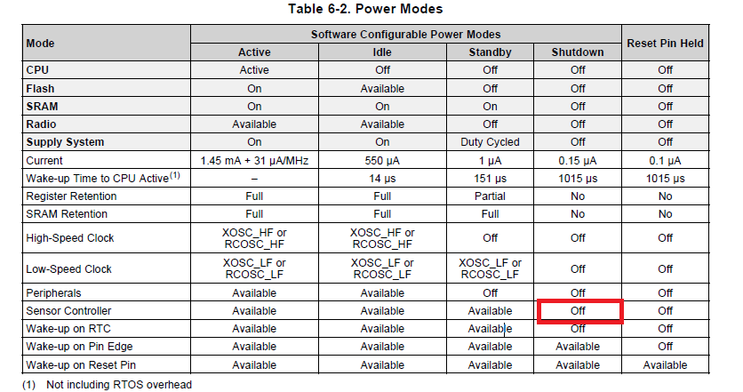

I want to enable shut down mode M0/M3 block.  And then, It is wake up from Sensor conconroller.
I tested code. but I don't wake up shut down mode form  sensor controller.
In Shut down mode, Sensor contoller is off from refering below table.
Is it possible  wake up show down mode form Sensor controller.
