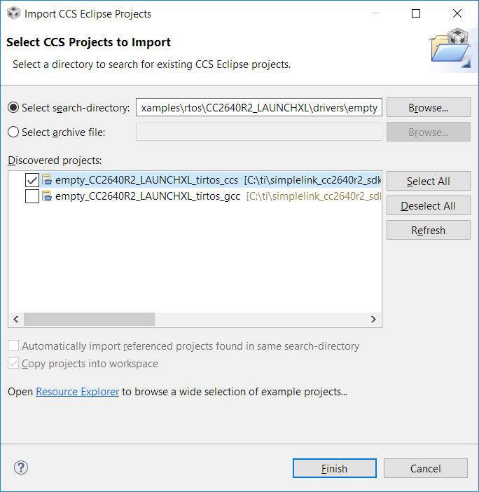

Could you please try importing another example from the SDK, for example the empty project located in C:\ti\simplelink_cc2640r2_sdk_1_50_00_58\examples\rtos\CC2640R2_LAUNCHXL\drivers\empty. In CCS go to Project -> Import CCS Project.
Pleas let us know if you see the same behavior.

I followed your directions outlined above.
I received the following error:
"Issues that may require your attention were encountered while importing the project(s):
Reason:
See details below."
The details said "Error: No XDCtools are currently installed!"
