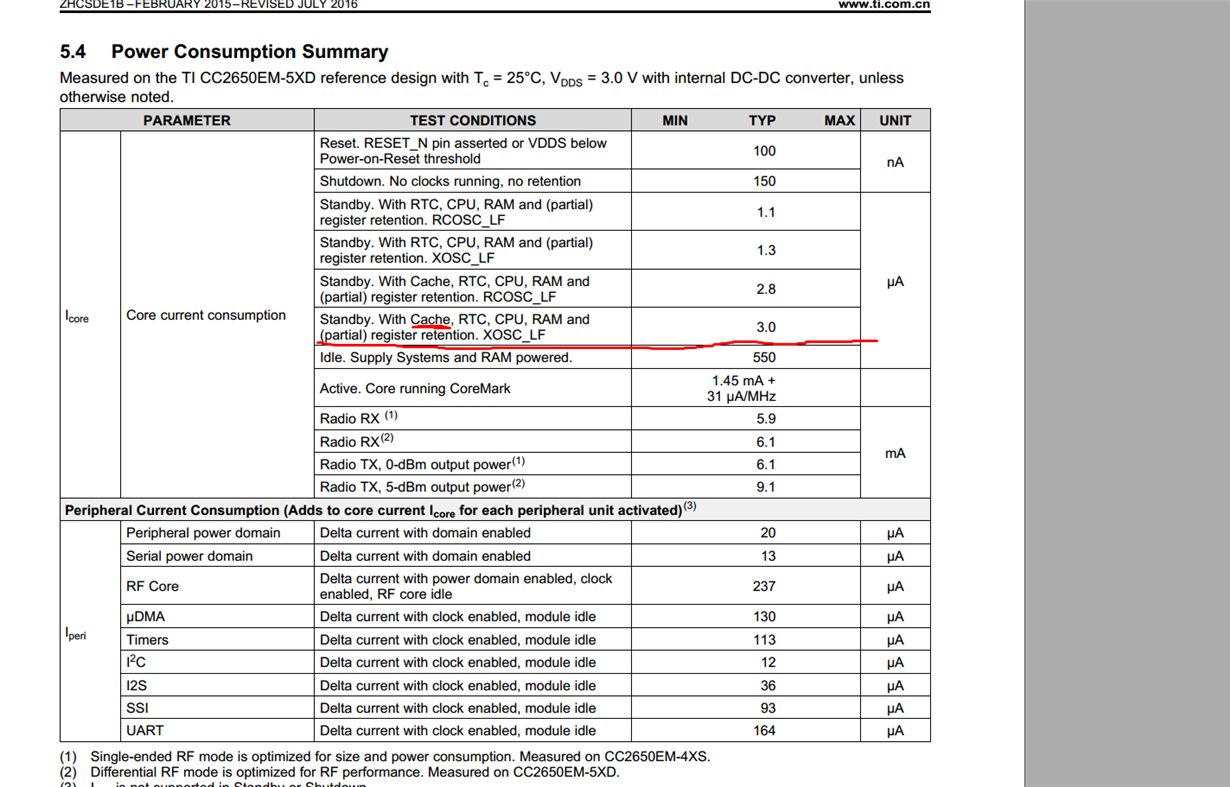

I measure my board's current, the average current is about 3uA which is conform to the Power Consumption Summary
When CC2640 enter standby mode and the XOSC_F doesn't working this time. But there is a high current about 1.2mA
every 500ms to 600ms. Is it normal? Do CC2640 will wake up itself every 500ms or 600ms, or there is something errors
on my boards?
Bellow is my current diagram.
Thanks.
