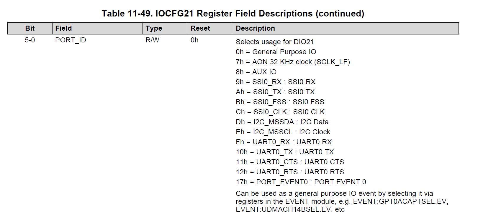

I am working on pin assignment with cc2640.
I want to use dio configuration, ICCFG, but can't understand how to do.
Could you give me a guide?
For example, if I want to configure pin 21 as AUX IO, I have to assign register as 8h.
is this right? then which file should I working on?
I kept looking on example project, but couldn't find where each pin was configured.
I attached the document that I am looking.
