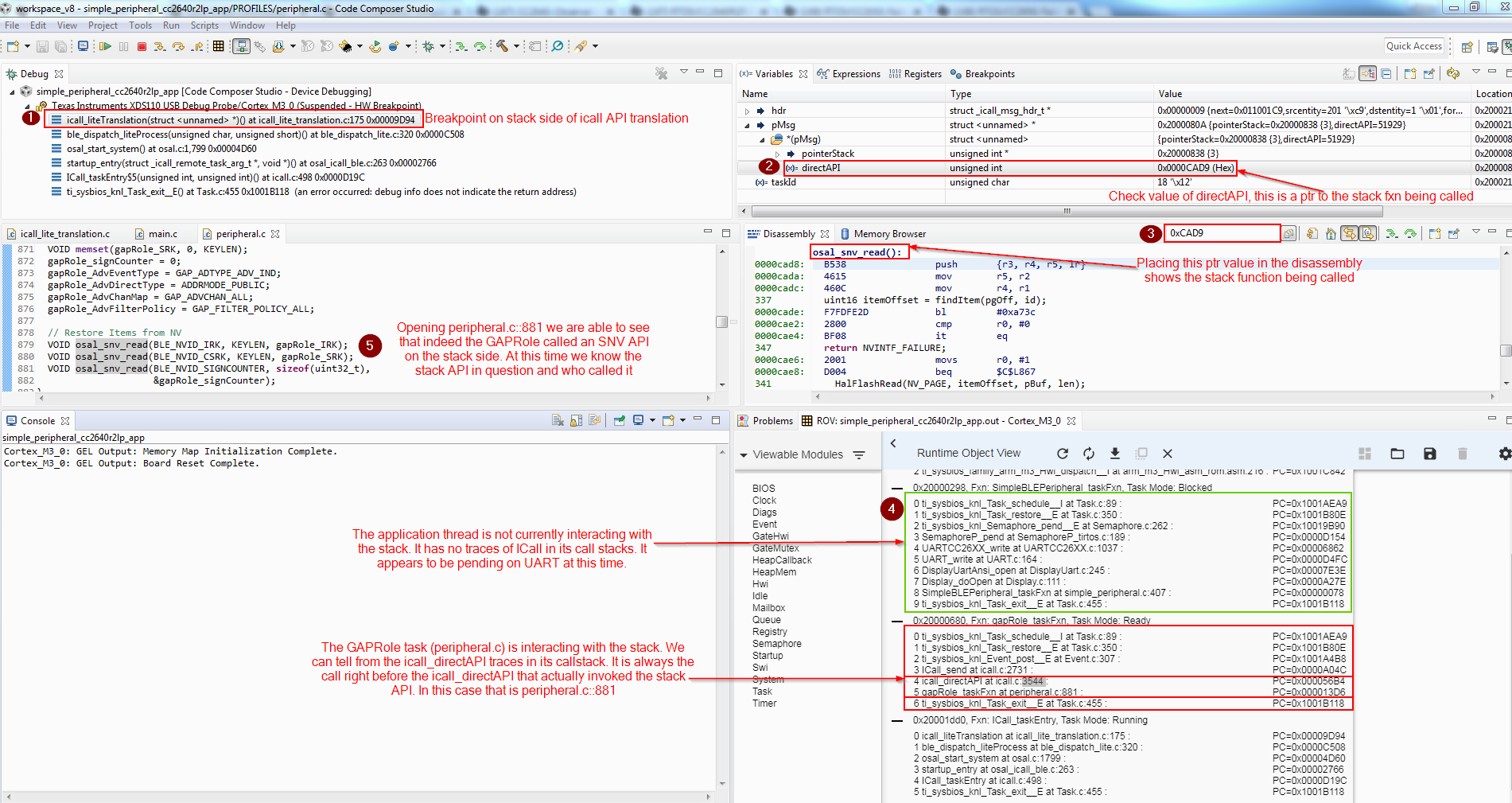

    That said, I will attempt to support the issue at hand. Here is the interesting part of your callstack, I have annotated it below:
    osalRegisterCtrlReadyInt() at ..\SCInterface\scif_osal_tirtos.c:78 0x000000EA --> Here is where things appear to go wrong, the previous call to the BLE-Stack has resulted in a Sensor Controller fxn being called....not good/does seem like expected behavior.
    ble_dispatch_liteProcess(unsigned char, unsigned short)() at icall_lite_translation.c:175 0x0000B97C --> stack task is running an API that was dispatched to it by the application. Here is executes the API directly
    When the failure is about to occur, can you set a break point at at icall_liteTranslation.c, line 175. At this time what is the value of pMsg->directAPI? I would suspect 0x000000EA based on the callstack above.

  • Hi Martin,
    Have you also ported the oad.c file to support images of type stack library? There are some changes required there and in the project files.
    Just checking.
    Using an unmodified simple_peripheral project (stack library) I am also unable to set a breakpoint in the icall_liteTranslation function.
    However, this is is just due to over optimization in the function (project defaults to O4) and usually the optimization can make debugging/breakpoints challenging.
    I removed optimization in the icall_lite_translation.c file by right clicking on the file --> properties --> build --> ARM compiler --> optimization --> off
    After removing optimization, I was able to set a breakpoint without issue. Note that I have annotated my CCS window to show exactly how I deduced both which stack API is under question and who called it.
    Note that the various task callstacks in the bottom right is accessible through ROV --> Task --> Callstacks. Please use ROV2 (tools --> runtime object view) to view this. With an application based on BLE simple peripheral there are only two tasks that will access the stack: user application (simple_peripheral task) and GAPRole (peripheral.c). If you have added more ICall aware tasks, then you may need to check other callstacks too.
    Please confirm that you are able to reproduce the above scenario with optimization disabled in the icall_lite_translation.c file.
    Once you have confirmed this, we will need to find an inventive way to only break on this function when it is about to fail. icall_liteTranslation() is responsible for matialing every API call so setting a breakpoint for each stack API call until the failure occurs is not feasible (there will be many).
