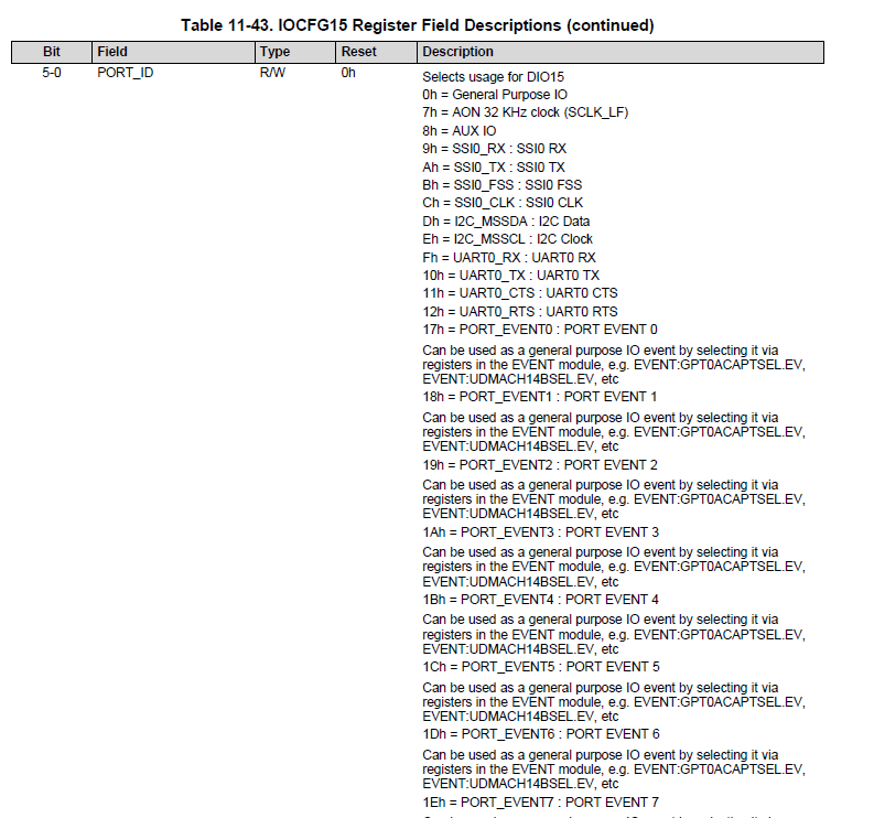

I want to set pin 15 as port event pin so I need to change port id part in register.
I already saw the pin example provided by ti but it does not change pin register but set pin configure structure.
According to the document, I need to set port id 17h to use pin as port event 0.
Which function should I use?
  • You can do something like this:
    #include <ti/drivers/pin/PINCC26XX.h>
    PIN_State testPinState;
    void *mainThread(void *arg0)
        PIN_Config testTable[] =
            IOID_15 | PIN_GPIO_? | PIN_GPIO_?, // Depends on how you want to configure the port
            PIN_TERMINATE
        PIN_Handle testPinHandle = PIN_open(&testPinState, testTable);
        PINCC26XX_setMux(testPinHandle, IOID_15, PINCC26XX_MUX_MCU_PORT_EV_0);
