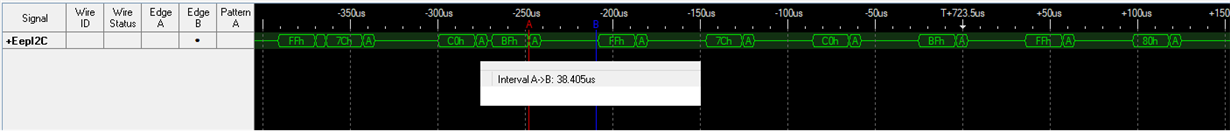

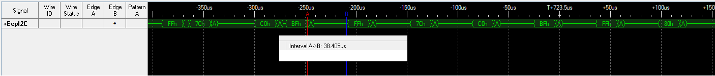

I see two strange effect when writing bulk data (258byte) to I2C:
1)
Sometimes (about 2/3 of the cases) there is a gap of 38us between two bytes
2)

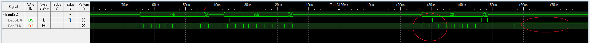

After some bytes (i.e. 24), one clock cycle seems shorter then usual (only 155ns). This byte is not understood by the I2C (eeprom) and gets not acknowledged.
Afterwards, the SDA line is kept low until a new I2C command appears. This seems to happen only on one of my devices, other ones work fine
Is there a possible improvement for 1) and what could be the root cause for 2)
Harald

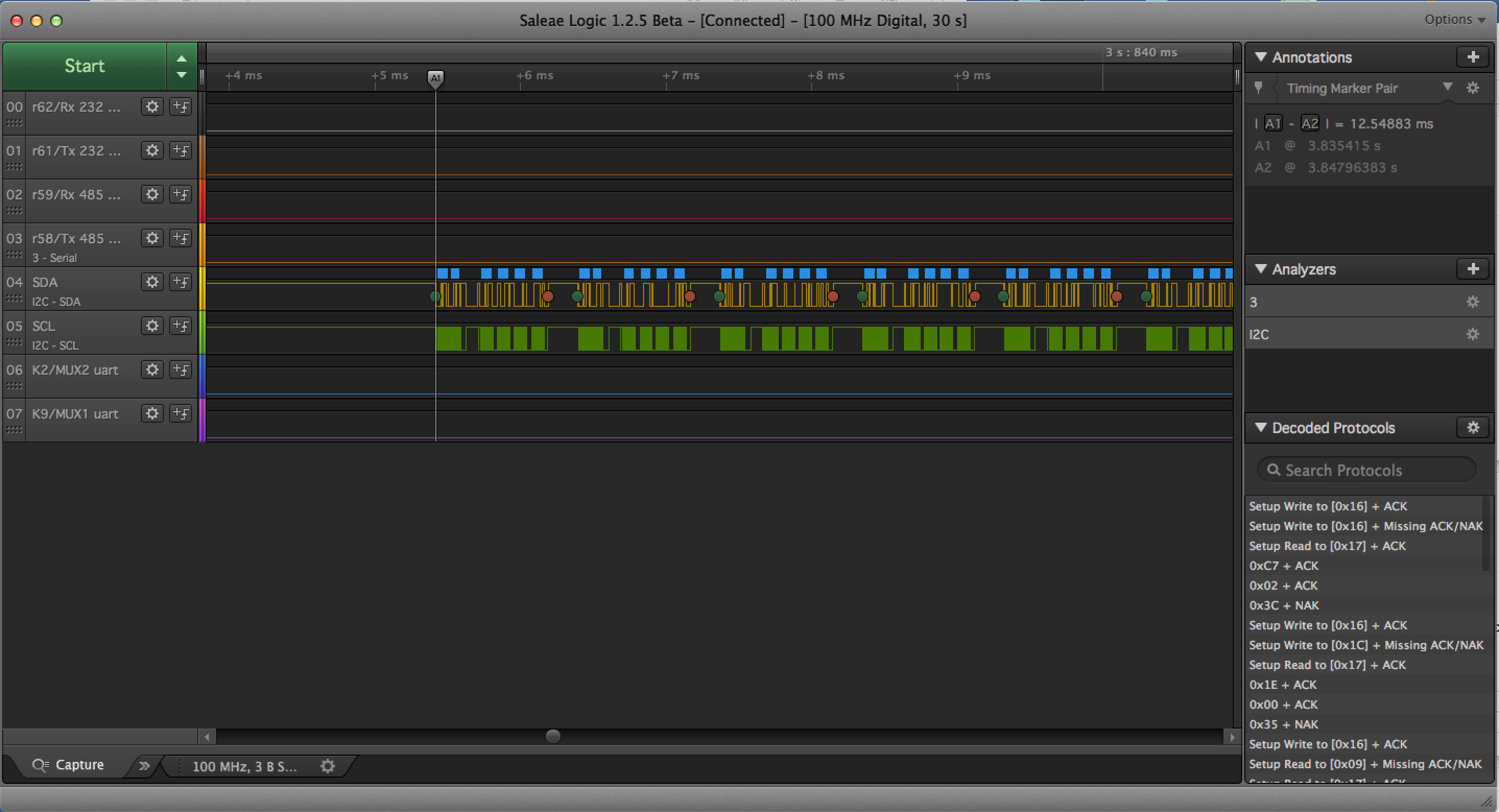

    I managed to save and now find an image ... this was a four months ago in the development of an MSP430F5438A product, running on its internal 8 MHz clock.
    In the image above, I have captured an I2C transfer, which is apparently 12.5 ms in duration (according to timing markers A1 and A2).  During this time, there was a extended SCL clock exactly every 1ms, lasting roughly 100us.   I instrumented every single one of my ISR's, (with timing signals on spare GPIO pins), and determined it wasn't my ISRs, but TI-RTOS's 1ms Timer interrupt.   I found the code for that, and saw it ran as an NMI (non-maskable interrupt) every 1ms.
    I am aware that the system tick can run at different intervals, and can be dynamic.  This is a project cfg file setting.  Yes, I could have changed that, however, that wouldn't fix my problem -- only make it less frequent.
    The I2C device was very well behaved, and I didn't lose data (I think).  In my case, the problem was the interrupt latency was so bad I lost UCSI_A2 receiver interrupts on a 115kb device.   This character flow from the other device was critical, because the protocol had no error detection or retries.
    I had to reduce the interrupt latency of the periodic system tick.  I ended up fixing the problem in two ways.  First, I fiddled with the project cfg file, and had the periodic system tick function do less.  (by turning off the code-timing option, and one other option which I don't remember the exact detail).   Second, we made a PCB fix, and installed an external crystal connected to XT2IN and XT2OUT, and now run the MSP430 with an SMCLK of 12 Mhz.
    We accomplished the reduction of interrupt latency, and the time to run the periodic system tick function was reduced to about 60 us. (or less now -- I haven't timed it in months).   I also checked the interrupt latency of all my own ISRs, and verified that they run in typically 10us to 20us.
    Sorry Harold, this is a little off-topic for you.  In your case the SCL signal is being badly mangled, in my case it was being extended.

    To move back to your topic Harald, the delay between two bytes that you see now and then can be connected to the system doing something else. The transfer is interrupt driver but chances is that there is currently another Hwi running at this point which delays the I2C one.
    The strange clock cycle I will have to look closer at. I'll try to put together a test and see if I can reproduce it. As it only happens on one of your devices, it is very likely that it is hardware related and a problem with that particular board.
