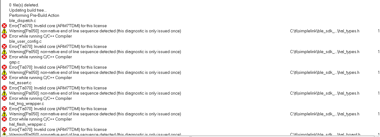

I am getting below errors after opening the sample code/ workspace  for SmartRF06 development board
ti\simplelink\ble_sdk_2_02_02_25\examples\cc2650em\simple_ap\iar\simple_broadcaster
After bopening workspace we get below errors
Error1 :
Error2:
Error3:

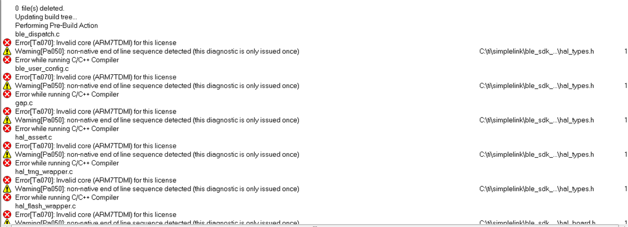

After building the cc2650em_app project I get below Error
Error4:
After building  cc2650em_stack project i will get below error
Error5 :
PLease Help to resolve this issue

    It sounds like you have broken the IAR project settings by opening it with an older IAR version (7.40) than it was created with.
    Because 7.40 is older, it does not understand some of the new project options that have been added by the newer versions.
    As per the release notes (release_notes_BLE_Stack_2_2_2.html), the supported version of IAR for BLE-Stack 2.2.2 is 7.80.4. Please revert any changes to the file, and use this version.
