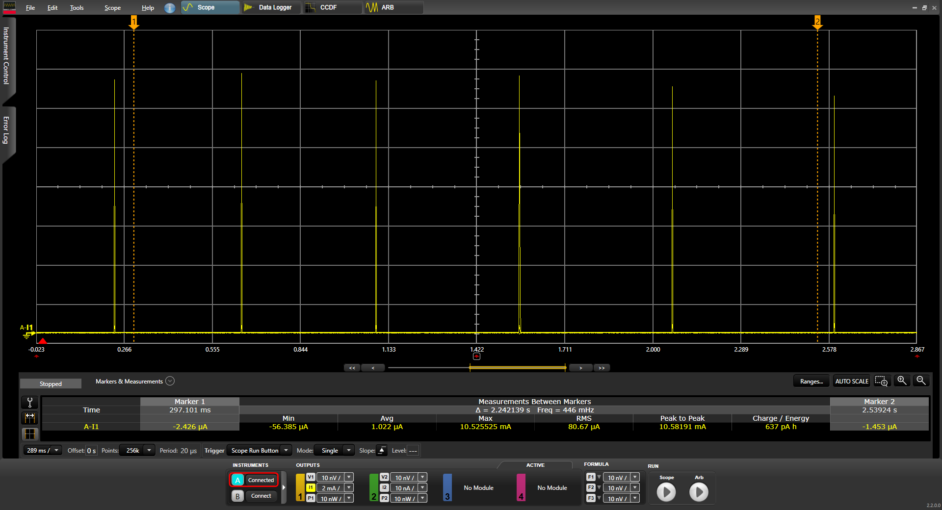

  • It is not necessary to do any reconfiguration to achieve the standby current consumption, but you must be sure that the BoardGpioInitTable table in CC2640R2_LAUNCHXL.c is set up according to how you want your DIOS to be configures when not controlled by the driver.
    I took the uartecho example from simplelink_cc2640r2_sdk_1_50_00_58 and did some modification to the code, to verify standby current when doing a UART_close.
    My code is below:

    in addition I turned off the external flash as this will draw extra current:

    As you can see from the plot I measure just above 1 uA in standby:

  • I tested with 1_40 as well, and did not too high current consumption there either.
    The two SDKs uses different Core SDK versions  and the bug fixes done from one version to the other is documented in the
    <INSTALL_DIR>:/ti/simplelink_cc2640r2_sdk_1_50_00_58/docs/simplelink_mcu_sdk/release_notes_coresdk_cc13xx_cc26xx_3_30_03_00.html#whats-new
    Only HW bugs are documented in the errata note.
    Are you testing on our HW or your own HW? I recommend that you do some testing with the same code as I used, to verify that you can get the correct current consumption then. If you still have problems, the issues must be related to your application.
