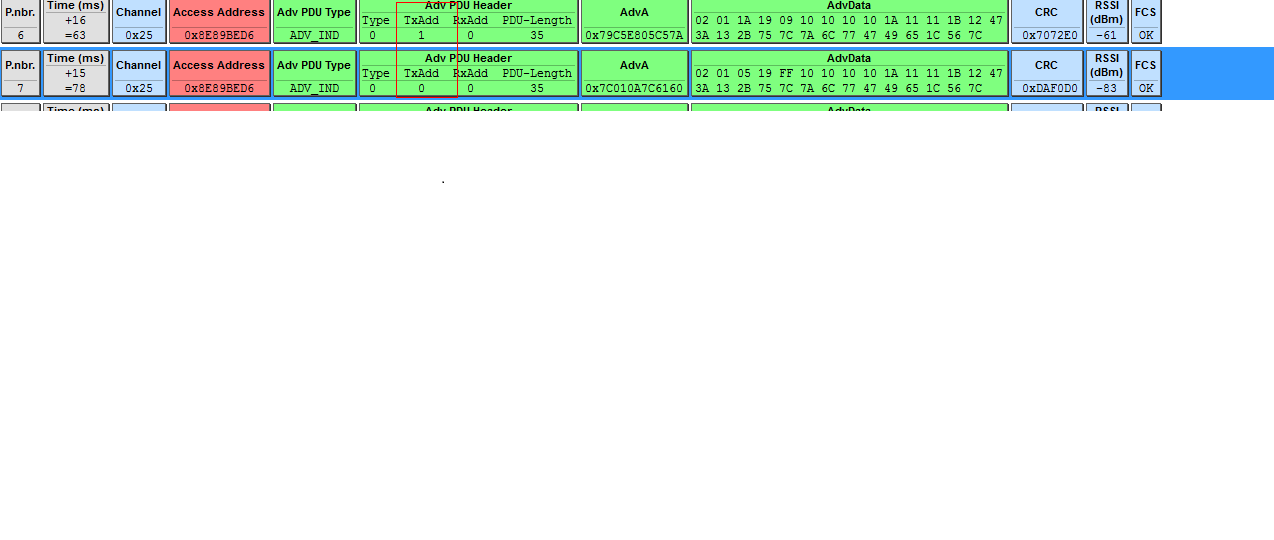

Hello,My project is  is based on MultiRole ,cc2640r2. the situation is that my board keep on scan the adv package of the cc2541 or  smartphone, and the adv package change about every 5s.however about after 30min, my board can not scan any adv package of any smartphone with Random Resolvable Private Address  but cc2541 whit public MAC,even whit the same adv package.
 we change the addr  gap of cc2541 whit  ADDRMODE_PRIVATE_RESOLVE. then my board can not scan the adv package of cc2541 too. it won't work evenif we retry scan but reset cc2640r2.
so we think if there is any limit of ble stack about scan the peripheral with  Random Resolvable Private Address ? after reach the limited number of RPAs,it won't scan adv of PRAs?
as this situation ,we have to reset cc26402r every 30min, how can we solve this promble?

  • Hi,I am using the multirole of the simplelink_cc2640r2_sdk_1_50_00_58,CCS7.4.
    just one,may be there are any adv package of smartphone. and the DEFAULT_MAX_SCAN_RES is 3.
    after it won't scan RPAs it still could be connect as a peripheral and exchange information.
    and it can be reproduced if use a andriod phone as  peripheral and change the adv package frequency(5 second or less ,as the RPAs will change when the adv package change)
  • any advise will appreciate

  • thanks your reply, I did set GAP_SetParamValue(TGAP_FILTER_ADV_REPORTS ,FALSE); and my multi_role device using a a public address.
    'cause for new product dislpay we haven't repeat the issue on other way but just reset...

  • sorry about relpy you in time ,we han't use the white list while scanning and paired and bonded whit devices
  • Okay, so the whitelist and resolving list are not in play at all then. And you are not enabling pairing or bonding at all, correct?

    Hi Sean,
    I faced with issue while scanning for cell phone that always uses RPA.  The issue is inability to find cell phone at all.  For experiment  I use HostTest_App based on SDK 1.40.00.45.   I did not do anything special, just initialize chip as central and start Device Discovery.  I was able to find devices with public and static addresses but could not find devices with RPA.
    Captured log is attached.
    Regards ,
    Sergiy.
  • Hi Sergiy,
    In the log you provided there are multiple advertisement reports of devices with address type random.
    Since you have not paired and bonded with the phone or shared an Identity Resolving Key (IRK) then there is no way to resolve this random address, thus they appear as random.
  • Hi Sean,
    I am talking about problem in the TI SDK related to the very first scan when I'd like to see all devices around.  The issue is observed only on TI SDK v.1.40.00.45 for CC2640R2 chip.    This SDK is not able to find cell phone with RPA.
    In the attachment you can find two logs captured simultaneously:
    - first one is captured by dongle programmed wth TI SDK v.2.2.1 for CC2640 and it successfully found cell phone with BD address 55:DB:A8:70:05:2D
    - second one  is captured by dongle programmed wth TI SDK v.1.40.00.45 for CC2640R2 and it couldn't find cell phone with BD address 55:DB:A8:70:05:2D
    Sergiy

  • Hi Sergiy,
    Not observing the device on the first scan is very different than not being able to discover the device at all.
    First of all, it appears that both the CC2640 and CC2640R2 are able to random addresses (as mentioned before all addresses are presented as random when no pairing or bonding has occurred).
    Second, there is only one scan in the logs that is performed, and it is not done at 100% duty cycle, thus there is no gaurantee that you are going to discover the phone in one scan attempt. This does not mean that the device cannot be found using the stack but rather means that the stack was not scanning at the same time as the advertiser was advertising.
    A better comparison would be to do infinite scanning for a given amount of time (let's say 1m) and see if the phone in question can be observed.
  • Hi Sean,
    Yes, in this example just one scan attempt which demonstrates a different behavior of these two chips+SDK.  But I tried to start a scan process several times and got the same results:  CC2640 with SDK 2.2.1 always finds a cell phone while CC2640R2 with SDK v.1.40.00.45 cannot find the cell phone at all.
    Note that cell phone advertise interval is 250 msec and I think this is enough to be captured by dongle.
    Do you have any ideas why I observe this different behavior?
    Thank you in advance,
    Sergiy.
  • Sergiy,
    The SW will execute with different timings on the two devices. Even starting a scan simultaneously, the link layer of each device will start a scan at different instants. Additionally, the stacks are different so the execution flow will be a bit different. So there is no guarantee that a single scan will capture every devices, especially when the scan is not at 100% duty cycle.
    We can't accurately say that the R2 device is not able to detect a phone until we can confirm that the device is scanning at the same time the phone is advertising.
    Can you run a test with continuous scanning with the R2 device to see if it can observe the phone?
