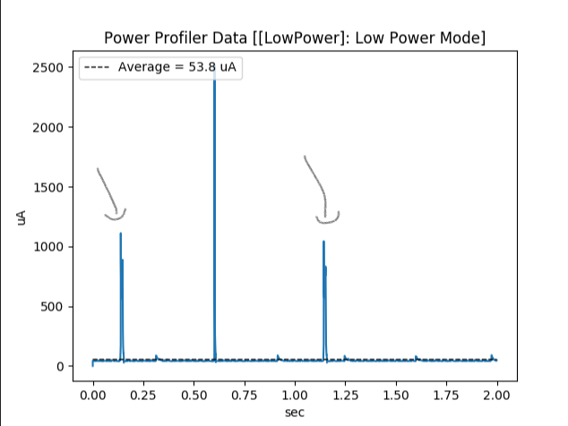

    When power profiling my custom device, I noticed a periodic 1 second very short power spike of a couple mA. I believe this is the processor waking up to service the RTC clock and the second Bios module. Would it be possible that the watchdog keeps counting during these power spikes, and then resets when reaching the reload value?

  • Attached: Device Power consumption with 1 sec periodic power spikes:
    Please ignore the spike @ 0.6s

           Regarding the periodic spike, it is normal, from what I remember it is the DC to DC recharge something. Anyway here are SDK v1.50 simple peripheral code for testing. I added watchdog_app.c and watchdog_app.h

  • I would not expect the device to wake up every second just because you are using the "Seconds" module, this would be horrible for power consumption. The module itself is wrapping the RTC, translating it into seconds; It do not require a periodic tick. I would assume that the spikes are the recharge pulses, they should not result in the watchdog ticking.
    You should not need to initiate the Icall and watchdog in any particular order what I'm aware of, I recommend having a look at the example posted by Markel and compare it to yours.
