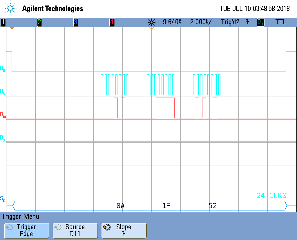

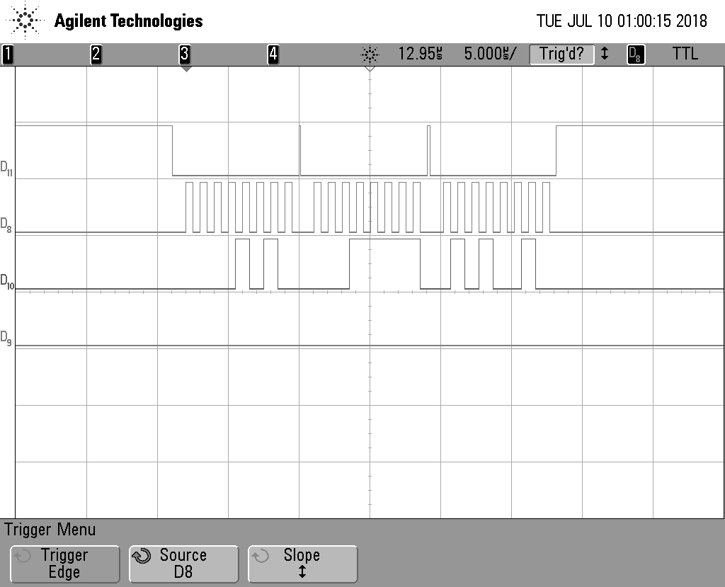

  • Hi AB,
    Changing to PIN_UNASSIGNED seems to fix the problem. I am still very stumped by no data from MISO.
    I've connected the ADXL sensor to an arduino and run sample code which shows the sensor works and has fine connections. Comparing the Oscilloscope readings from the Arduino to the Launchpad show a couple basic differences. The first Difference is the Chip Select in the arduino goes low earlier than the launchpad and stay low for the length of the transfer (compared to going high between bytes). The second difference is for the arduino, MOSI is default high.
    I suspect the issue is with Chip Select rather than MOSI, as MOSI still goes low in time for the first rising edge of the clock. For Chip Select, I also tried implementing a software CS, where a pin manually was set low before the transfer and then pulled back high but that didn't seem to fix anything (Though CS was low a long time before the clck started). In addition I disconnected MISO from the launchpad and connected it straight to the scope so as to test for and error in the sensor being able to pull the PIN high/low but that seemed to have no effect.
    Reed
    Successful Arduino Transfer (triggered on Clock, so CS is not shown going low)
    Launchpad - Hardware CS
    Launchpad - Software CS
    the reason for the MOSI pin going HIGH between transmission on the Arduino and not on our device is because you have the pin setup with a pull down(I do not think this the problem either as the sensor's datasheet states that the MOSI pin is a 'Don't Care' when it is not transmitting):
    CC2640R2_LAUNCHXL_SPI0_MOSI | PIN_INPUT_EN | PIN_PULLDOWN, /* SPI master out - slave in */
    CC2640R2_LAUNCHXL_SPI0_MISO | PIN_INPUT_EN | PIN_PULLDOWN, /* SPI master in - slave out */
    CC2640R2_LAUNCHXL_SPI0_CLK | PIN_INPUT_EN | PIN_PULLDOWN, /* SPI clock */
    You can try making it a pull up and see if this fixes the issue.
    You can make CS pin SW controlled and make sure you pull it down before you start a transmission by putting a delay in between transfer and pulling it down. According to the ADXL datasheet the time you need is atleast 100ns.
