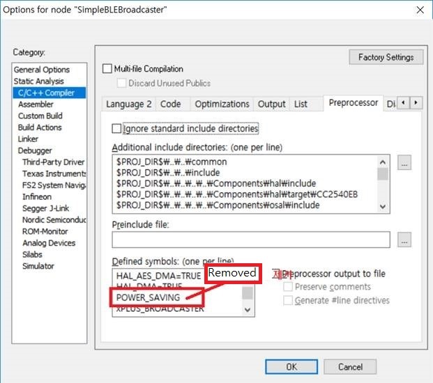

    To avoid any unexpected stabilization time of external 32MHz -Xtal,    we deleted POWER SAVING feature in IAR preprocessor as
    attached picture with another set.    Then we found  2.9hrs advertisement stopping condition was happened again.
    we have verified that 32MHz X-tal oscillation never stop.   But happeded.    Any other factor to get into the stop for 2.9hrs except
     32MHz wake up stablilization from sleep?     As I said in previous explanation,  advertising duration is 100msec.
