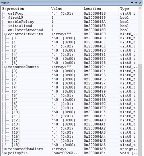

  • Hi M-W,
    Please see below our PowerCC26XX_module in IAR. It looks like 2 is set in constraintCounts which corresponds to PowerCC26XX_SB_DISALLOW in the PowerCC26XX.h file. Because of this, we are never able to get to Power_sleep(PowerCC26XX_STANDBY) and instead we get to PRCMDeepSleep().
    How can we check to see what is setting this preventing our device from running the Power_sleep(PowerCC26XX_STANDBY)?
    Akash
  • Hi Akash,
    There is no good way to say that "This is what causes it" but you can use the resourceCounts to track the cause of your problem.
    For example, you can see that the RF_CORE, SERIAL and PERIPHERAL domain is all active (the later have 3 dependencies which means at least 3 drivers require this domain to be active). You also see that the UART0, TRNG, GPIO, CRYTPO, and XOSC_HF is turned on.
    I would suspect either the RF or UART part of the code keeping you out of standby. Have you made sure there is no active UART_write/read calls (callback mode included) and that the Radio is not left active?
  • Hi M-W,
    Thank you for the help. It appears the issue we had here were active UART_reads that was preventing us from running Power_sleep.
