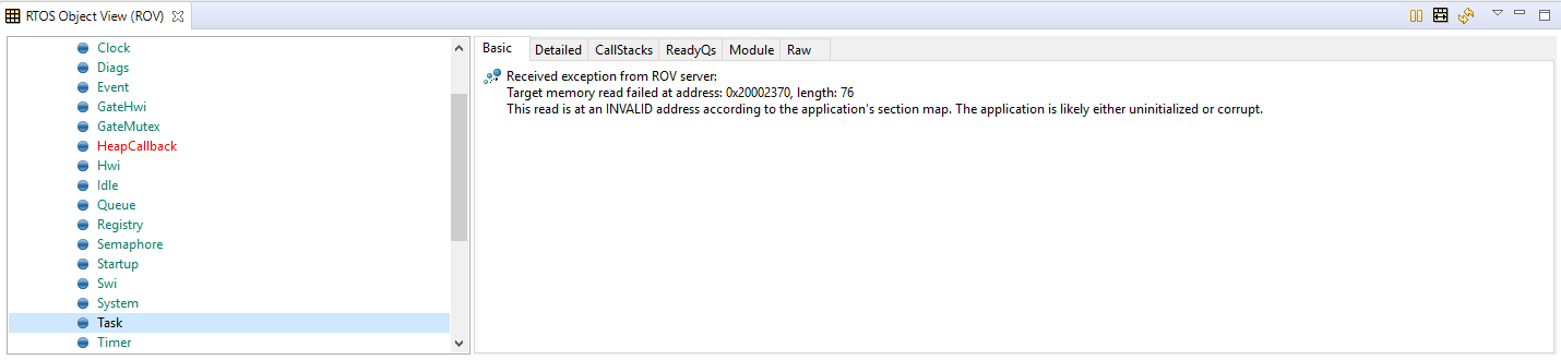

    I cant read tasks in ROV anymore. SWI and HWI are normal. Therefore I have followed the instruction at the Debugging User Guide.
    Before I press the start Button in Debug Mode it looks
    and if I press the start button and pause the program.
    Furthermore the execution graph is empty. It doesn't matter if the kernel is in Flash or RAM.
    Do you have an idea what's wrong?

  • Hi Christian,
    Did you make sure to disable using the kernel from ROM as well as enabling BIOS.logEnabled? I tried adding what you did along with these changes and for me it all works as intended. Remember you also have to halt the CPU to display the logged information.

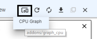

    9. when debuging, press Tools  -> Runtime Object view, connect to the debugger.
    10. in the ROV, press settings and add "Add-on views" and import the CPU Graph.
    11.add the CPU graph.
    refresh the graph.
    It  works.

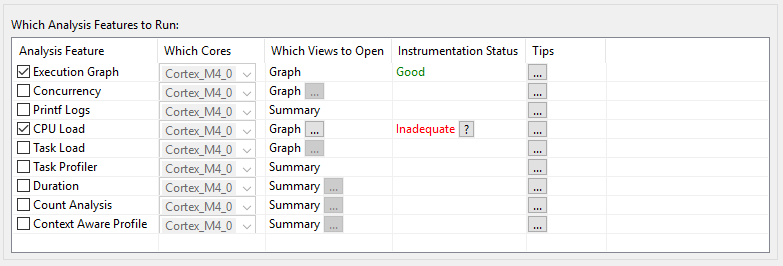

  • Thanks to Netanel Unger  and M-W,
    the Execution Graph works. But I can't see the CPU Load (see picture below)
    I have added
    var Load = xdc.useModule('ti.sysbios.utils.Load');
    to the clock configuration section of "cc2640_r2_csdk.cfg" , and added
    * LoggingSetup configures TI-RTOS modules to capture user-specified information
    * such as CPU Load, Task Load and Task Execution so that it can be
    * displayed by System Analyzer.
    * loadLogging: (default = true) If true, LoggingSetup will add the kernel's
    * load module, which measure the CPU load. See the BIOS API
    * documentation for usage details
    var LoggingSetup = xdc.useModule('ti.uia.sysbios.LoggingSetup');
    LoggingSetup.loadLogging = true;
    LoggingSetup.loadLoggerSize = 256;
    LoggingSetup.loadTaskLogging = true
    LoggingSetup.mainLoggerSize = 512;
    LoggingSetup.sysbiosLoggerSize = 2048;
    LoggingSetup.sysbiosSwiLogging = true;
    LoggingSetup.sysbiosHwiLogging = false;
    LoggingSetup.sysbiosSemaphoreLogging = true;
    at the end of the .cfg-file.
    Do u have any idea why CPU load is inadeqate?

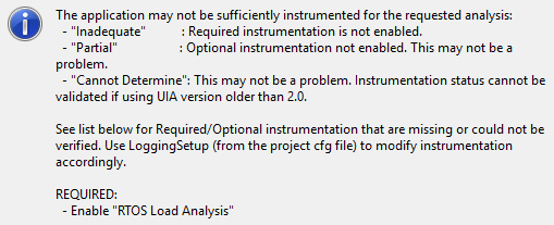

  • Could you share the while cfg file so that I can go over it? Also, what does CCS tell you if you check the "Inadequate" question mark?
  • Hi M-W,
    if i click on the question mark i see
    My whole .cfg file:
    cc2640_r2_csdk.cfg
    Christian
  • Hi Christian,
    I have the same basic configuration as you and I do not see the "inadequate" issue. I expect to see this if LoggingSetup.loadTaskLogging = true is set to false which I could verify.
    Have you tried this out on a basic "empty" example to see if you get it to work before doing it on the BLE project?
