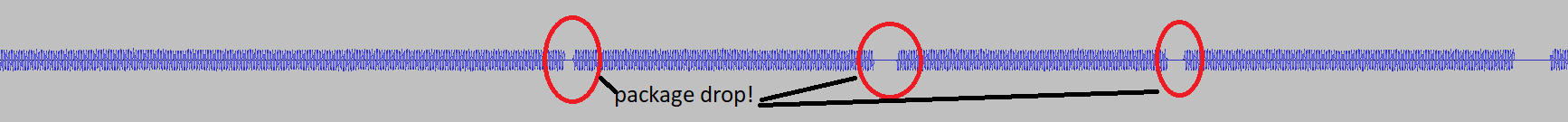

But when I test with 1kHz sinewave with CC2540 USB, there is package drop after 15 to 20 seconds..
If I disable CACHE_AS_RAM and disable BOARD_DISPLAY_UART, it doesn't have package drop over 30 seconds!
Does the CACHE_AS_RAM affect the performance? How can I improve the audio quality?

    I believe we need to figure out where the audio packet drop is occurring, since the BLE protocol is designed to not drop any packets at all. Are you able to verify if all audio data is successfully transmitted OTA? I am specifically a bit uncertain on the capabilities of the CC2540 side.

    I tried following setting:
    1. Disable CACHE_AS_RAM and diable BOARD_UART_DISPLAY , no audio drop
    2. Enable CACHE_AS_RAM in bim and app -> Audio drop happen!
    3. Enable CACHE_AS_RAM in bim and app , but I comment the .bss to GPRAM in cc26xx_app_oad.cmd, add .bss back to SRAM, audio drop also happen...
    //.bss :0
    // (.bss)
    // } > GPRAM
    I didn't change program code, why enable CACHE_AS_RAM will cause the audio drop?
    Is there any help if I increase the PDM_TASK_STACK_SIZE or HAR_AUDIO_MAX_ALLOC_BUF ?
