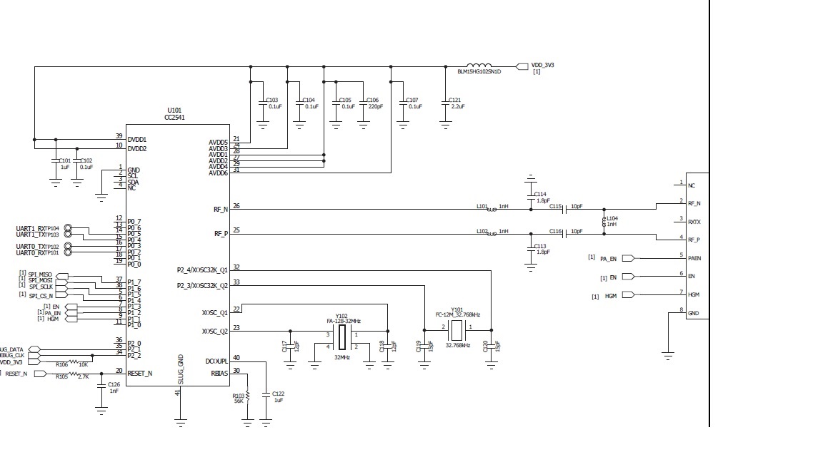

The schematic is as attached.

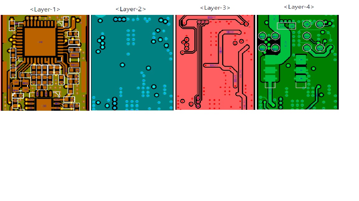

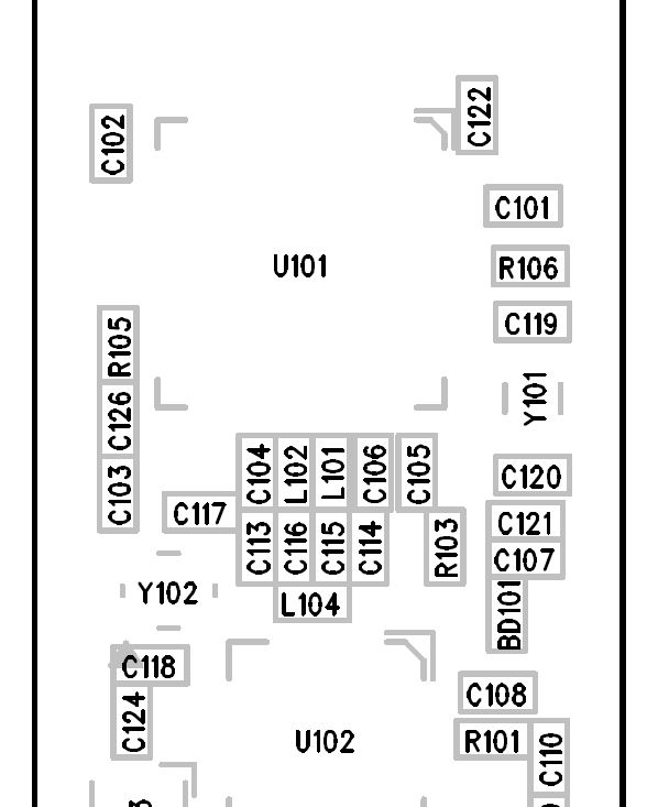

    Would you mind if we check your HW design schematic and layout? The problem is a bit weird since the timer wrap around is for sleep timer which when you disable PM, you should not observe the same.(Somehow you are still seeing it...)
  • Hi Christin,
     Pls refer to the attached PCB gerber files.
    Since I already uproaded sch file in previous posting,   I'm posting PCB related files only at this time.
    U101 is CC2541 and U102 is CC2590.   1pin of each parts are located to upper right position.   Y101 is 32.768KHz RTC and Y102 is
    32MHz X-tal.   And dark green color of layer1 is copper plane connected to GND.    Since we refer to the CC2541-CC2590 ref design,
    the schematic and PCB file will be almost same with the TI ref design.

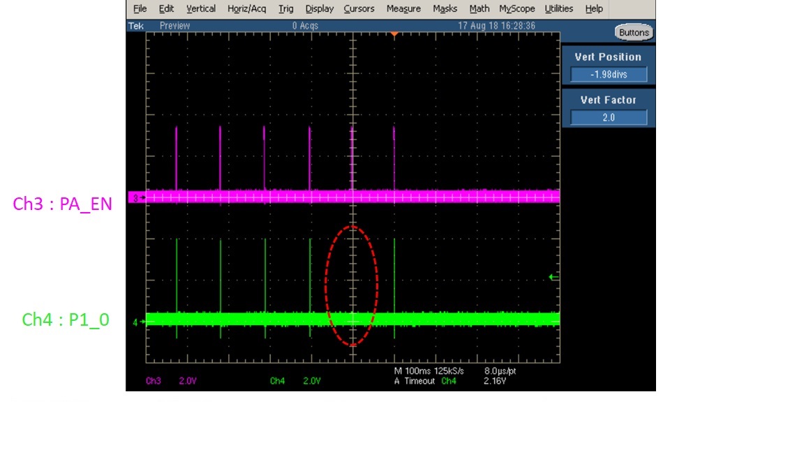

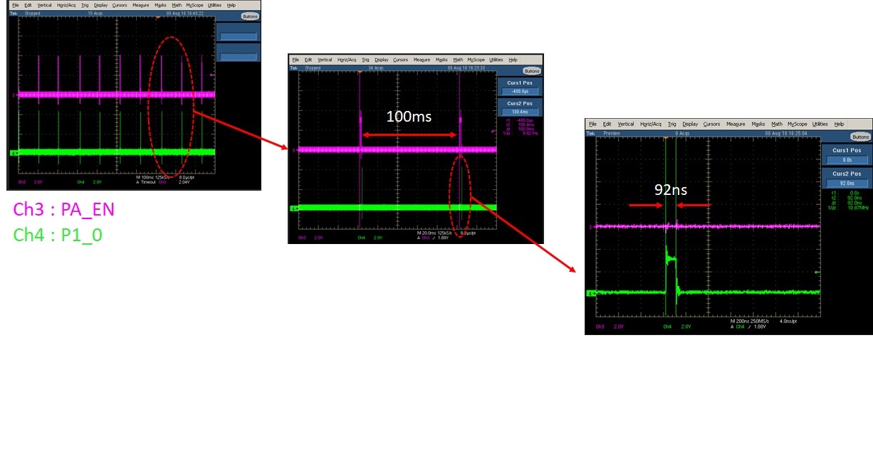

  • Hi Christin,
     The failure for 2.9Hr was happened again.
    Due to the difficulty of selecting logic analyzer,  We captured with 1GHz scope using the conditional capture when no triger signal is happend for 120msec.
    The test condition is power_save mode disabled.
    What I see and Important factor is ;
     1. Before it goes to fail,  Even PA_EN signal is generated normally.  But the  osal_run_system( void ) in OSAL.c  was not routed.  (No toggle as below).
     2. After 100msec have passed,  the PA_EN signal was generated.   And S/W get into  osal_run_system( void ) in OSAL.c again.   (toggle was found)
     3. And advertising stopped with no PA_EN & toggle for 2.9Hours.     And get back to normal.
    If you see below picture,   you will find this.    But due to scope's storage limit,   we couldn't zoom in how many toggle was happened before it stopped.
    We have purchase 25kset of CC2541 /CC2590 on hand.  and 5ksets was on buyer's hand,   and got serious blame from old buyer.
    I'm loking for you and TI engineers' strong attention to fix it.       If needed,  I'll forward the whole source code for you to verify and fix.
    Then let me know the e-mail address to send the whole code.    Since the problem was happened 2 months ago,   It's urgent !!
    YS Kim

    I measured the malfanction task event using Saleae logic analyzer by making intentional WD reset by touching RTC X-tal long time.
    You may download the Saleae logic analyzer program in the web site by free.
    It looks this web do not support file name "24 MHz, 720 M Samples [7]6.logicdata".      I cannot upload.
    YS Kim
