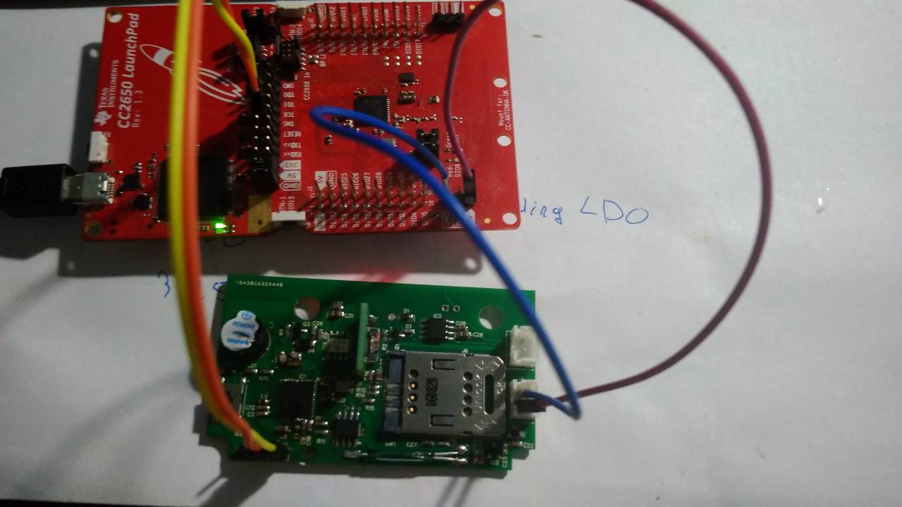

The CC2640 sometimes is no longer responding.
Video is here:  https://www.youtube.com/watch?v=-8415I2EOpk
I can not explain it, because I do not touch the PCB, it's sitting next to me and then it stops responding.
I can flash the chip 2-50 times, and then it stops responding. I can not clean it, it can not be reset, it's broken. Then I change it to a spare chip and it works
We have had this feedback""
[GN] - Actually we saw a similar problem on one board here, we have no idea why it happens but some Google searching shows other people have had similar problems, it might be down to the fact that the firmware is only partly programmed. Aaron found on one site that they suggested if you remove the 24MHz crystal; so the partly loaded firmware cannot start; then you might be able to mass erase the device and then refit the 24MHz crystal but I don't think we tried that here."
And have tried it but for some reason, it keeps happening and we cannot just flash the chip and use the boards
its making firmware development impossible
Any ideas why this may be happening?
