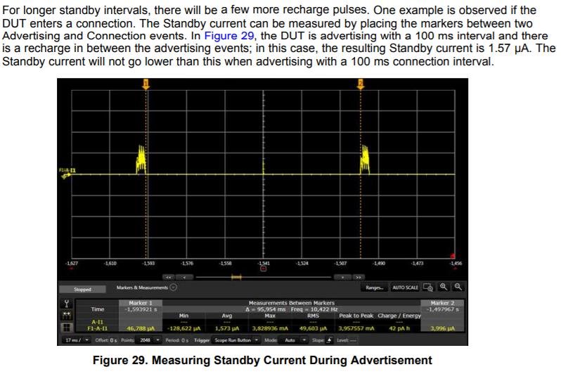

After I study below apps note for recharge pluse, I found it seems like need a few more recharge pulses for long standby interval.
My problem is how long standby interval need one recharge pulse?

  • There is no fix answer regarding this question. The device will recharge when it's needed. If you have more leakage current during standby(leakage from IO configuration...etc), then it will recharge more often.

  • Hi Janet,
    The Standby current values listed in the datasheet include recharge pulses. As you can see from the application note the current consumption between the pulses is <100 nA so the average is thus just above 1 uA with the pulses.

    I have saw "6.8 Power Management" and study this apps note again, it only need few recharge current for long standby interval.
