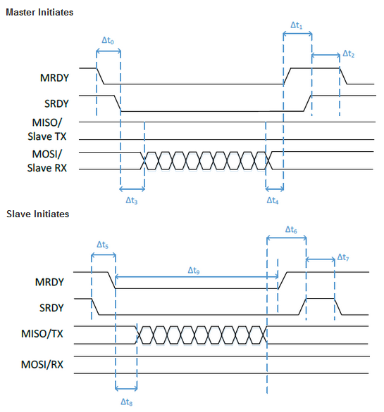

      • There is no pulse with respect to SCLK you posted to TI Wiki or Forum. Only MRDY, SDRY, MISO, MOSI pulses are there. Is the SCLK not being used? Just no pulse on the diagram picture?
    J
    In this diagrams, SCLK is implicit. You still need the SCLK signal.
