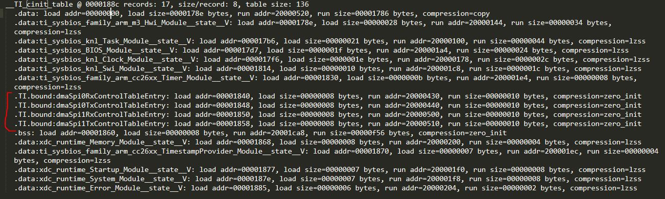

Now, I try to modify the simple_peripheral project example in /ti/simplelink_cc2640r2_sdk_2_20_00_49/examples/rtos/CC2640R2_LAUNCHXL/ble5stack adapting him to my project, to use BLE 5.0. When I finish I have a problem with memory, in particular with .cinit section, that exceed the max value.
I tried to delete the parts of the simple_peripheral project that I don't use an I tried to compile him without adding the parts of my project, the project is build but if I see the memory allocation .cinit section with view->memory allocation I see that its value is already very close to the limit. So when I added my project component I exceed the limit, while with my original projet in bluetooth 4.2 I'm very under the limit.

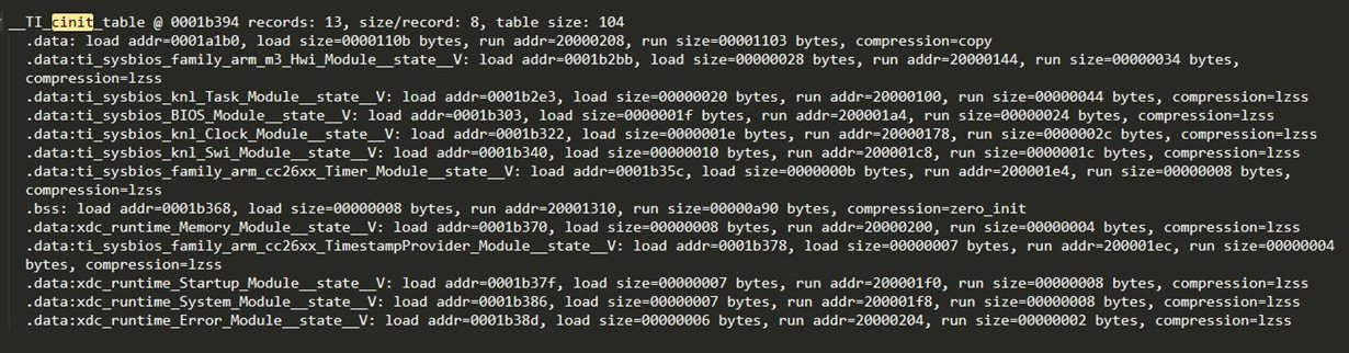

  • allocation.pdf
    As you can see from the file  .cinit section is only 1.516  in my project with 4.2 . In the BLE 5.0 without change to simple peripheral project it is greater than 5000.

  • file.zip
    I have attached .map file and linker.cmd file, I'm not sure that I understood what files you asked me.

    I verified now that when I introduce
    ADC_init();
    to initialize the ADC the memory allocation explodes.

    I see the FAILED TO ALLOCATE message in the .map file. Was this reported as an error in CCS errors/issues window?
    with exploding I mean that it does not fit memory.
    with reference to error 133, I use a custom app and sorry but I have not a sniffer, only the hci bluetooth report from the smartphone.
    The FAILED TO ALLOCATE is report as error from CCS.

  • Hi Giuseppe,
    Based on the .map file you provided, it looks like some dmaSPI control tables are being added to your .cinit. Can you tell me what changes you are making to your example and confirm whether or not you are making any changes to your memory?
    Please be aware of the amount of application code you add and how much flash your example is using. If you want to use BLE5, it is recommended that you upgrade your device to the CC26x2 if you plan on adding a significant amount of application code since that device has more available memory.  Otherwise since BLE4.2 is suitable for your application, I would recommend staying with BLE4.2 instead of upgrading. BLE5 is backwards compatible and will still work with BLE4.2 devices.
    Your .map file:
    Out of Box BLE5 Simple Peripheral .map file:
    I add the ADC_init, the Sensor_I2C and external flash control pin, and some other added to drive external Relè when certain events occur.

  • Hi Giuseppe,
    If all you added were TI-Driver calls then your application code uses too much memory for BLE5 on the CC2640R2. You can either reduce your application code or consider what I recommended above.
