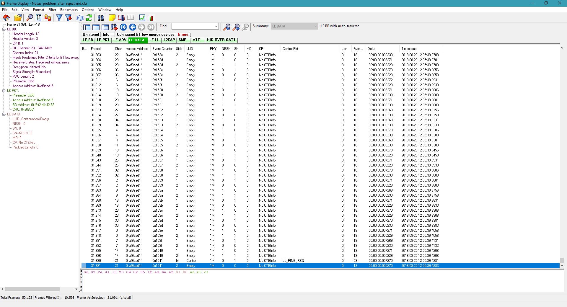

  • Hello Tim,
    As you can see in the figure, the Master sends a LL_CONNECTION_PARAM_REQ, and the slave does not respond.
    Regarding the "link goes down", what happens is that the Slave and Master just stop sending empty packets (the connection is dropped).
    Again, this only happens when the Android device (Master) sends the LL_REJECT_EXT_IND. If I use an Android device that does not send this, the link is maintained like expected.
    Why is this happening ? Is that a known problem of this SDK ?

  • Can you just attach a screenshot of the part where the connection drops?
  • Hi Tim,
    Here it is:
    Walter Pires
  • Ok so the master is terminating the connection because of the 40 second link layer control procedure timeout after the slave never responds to the LL_CONNECTION_PARAM_REQ. The strange thing is that the slave successfully maintains the connection until this timeout occurs. I would expect it to have crashed.
    I don't see how to debug this without instrumenting the stack so I may need to try to reproduce this.
    Is this repeatable? That is, does the slave not respond to the LL_CONNECTION_PARAM_REQ every time the the master sends the Reject?

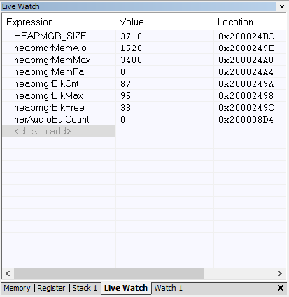

  • Also, can you profile the heap to see if there are any failures? See the "Debugging Common Heap Issues" of the software developer's guide; software-dl.ti.com/.../ble-common_heap.html
  • Hi Tim,
    Yes, this is only happening with Android devices (masters) that sent LL_REJECT_EXT_IND.
    Yes, this is repeatable, and always happens if the parameters are rejected by the master.
    Also, I used the define HEAPMGR_METRICS, and see that there is no failure on the heap.
    Here it is a capture of this values:
    So maybe there is a problem on this SDK when the device receives a rejection by the master. Can you check this on your side ?
