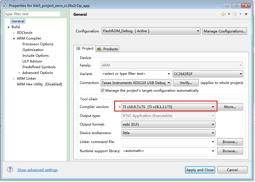

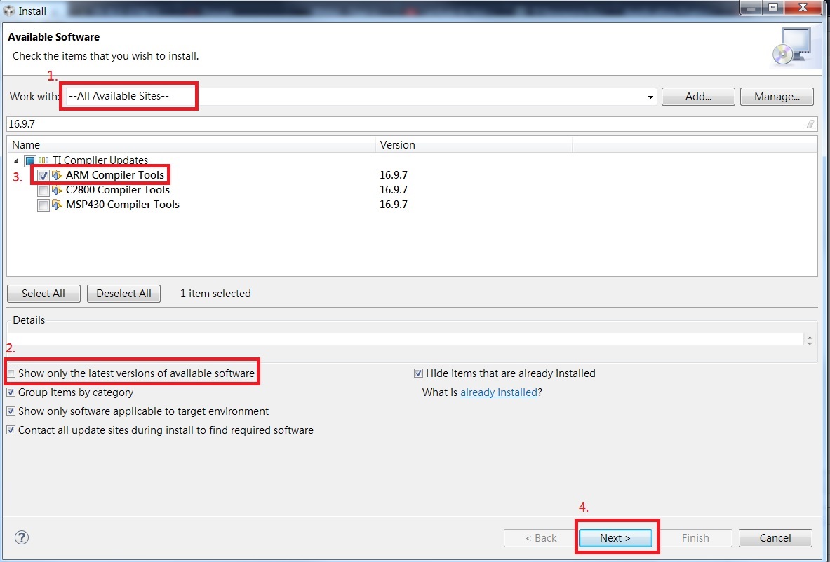

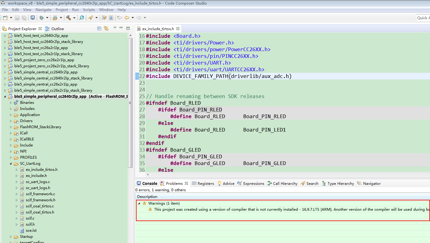

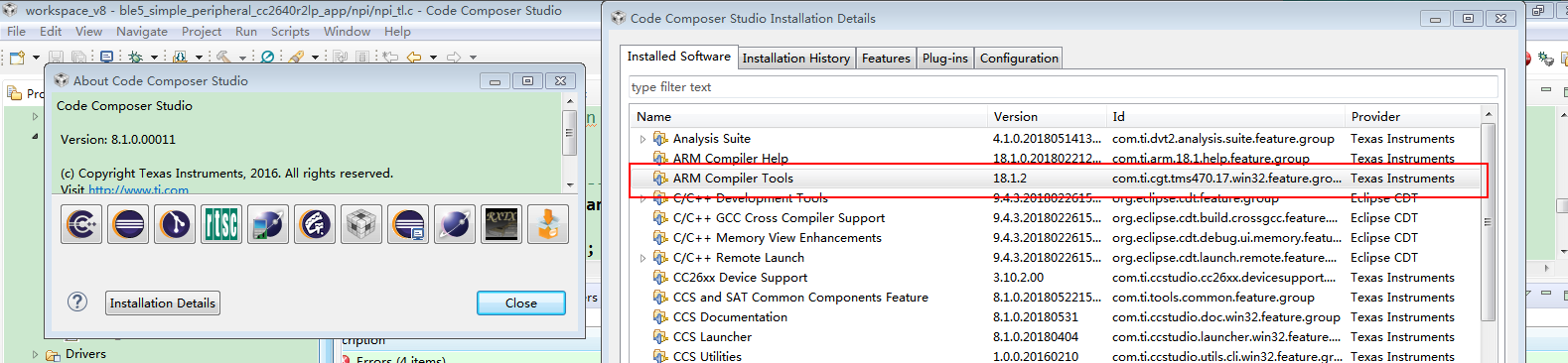

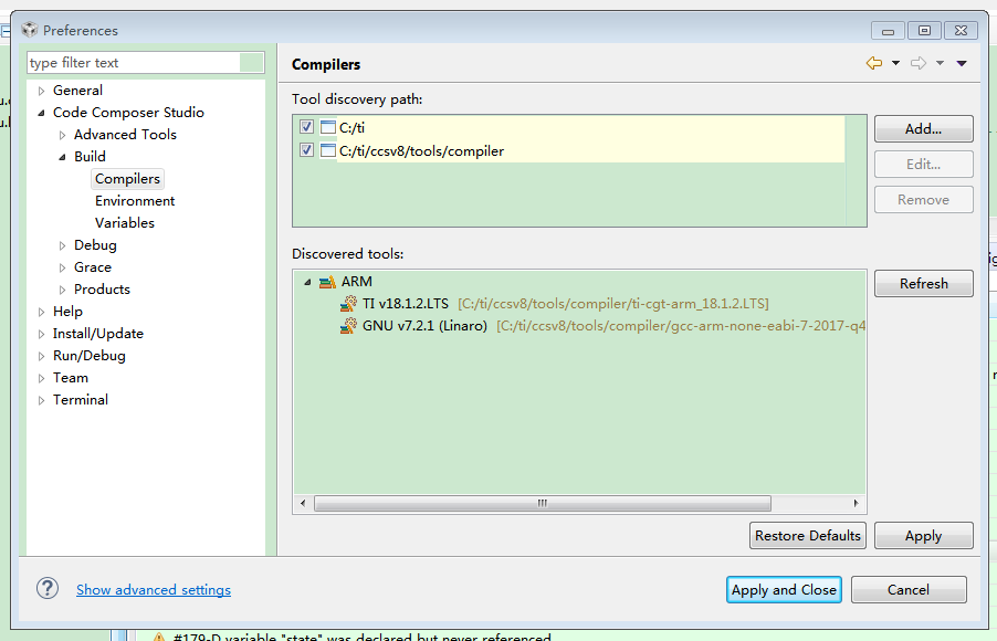

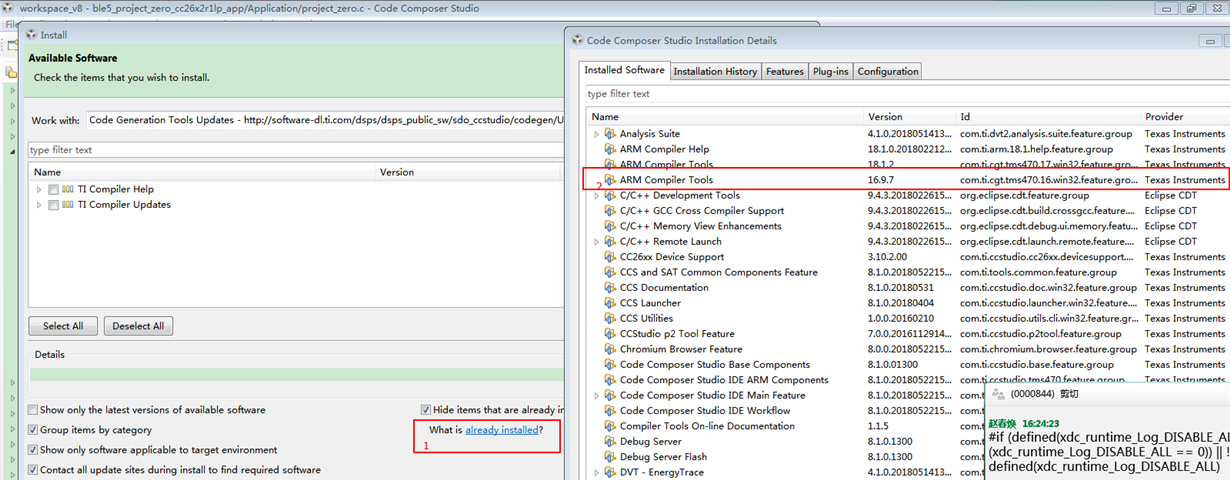

1)After I update CCS to the latest version, and open workspace_v8 (there're project imported by the old version CCS), doing rebuild of any project will cause warning even I never change a word of the project, just copy to the workspace by the old version CCS, does the warning matter?

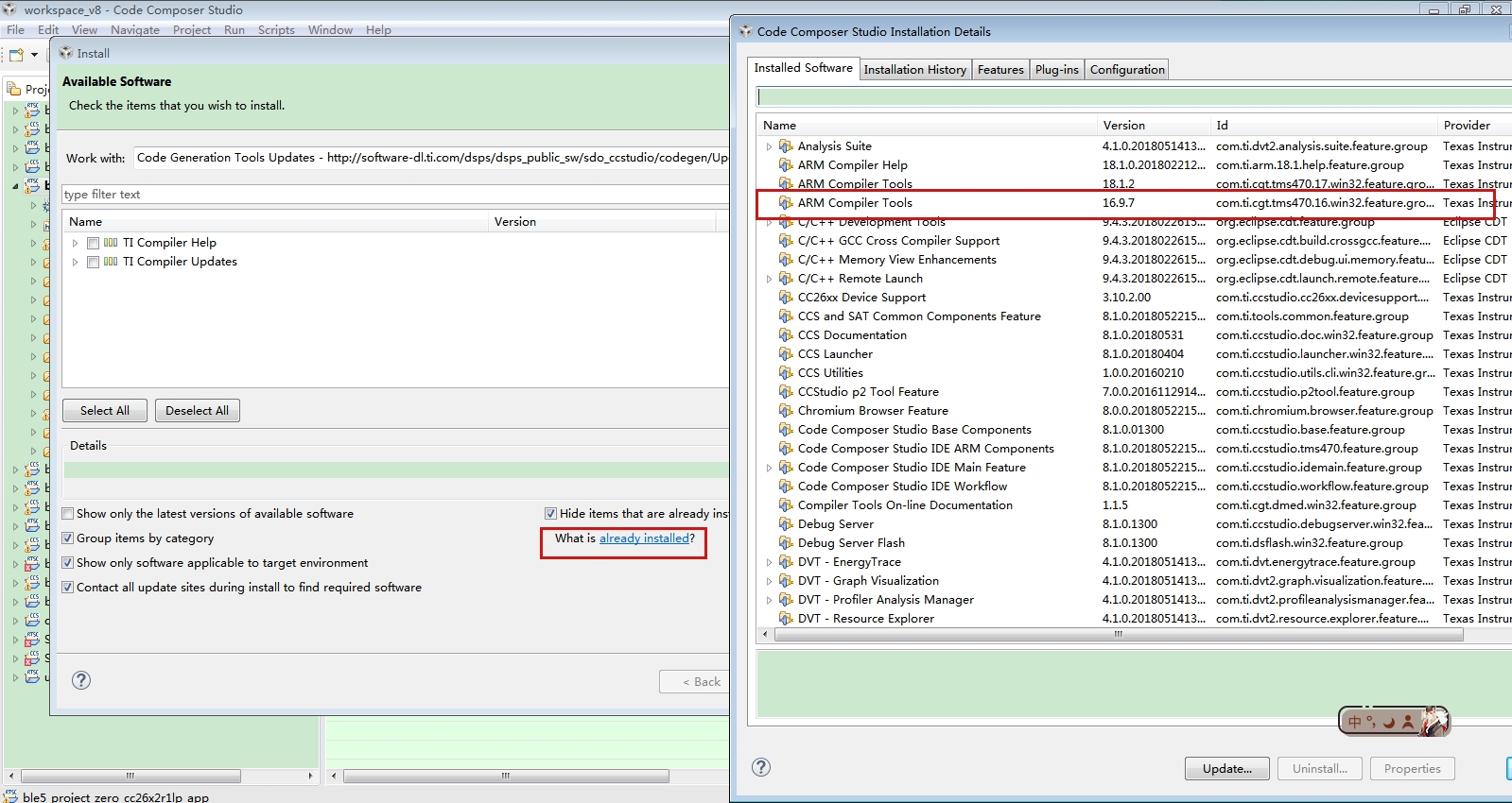

2)any update of CCS will cause the IDE cant open. Update like the below .Double left click on the icon won't open the software, right click on the icon and choose "run as admin" sometimes work and sometimes dont.  I have struggled with this problem nearly two days, restart the software, restart the computer have no effect, only reinstall CCS can fix this.
If i update as the warning suggests in question 1 will also cause the question 2.
