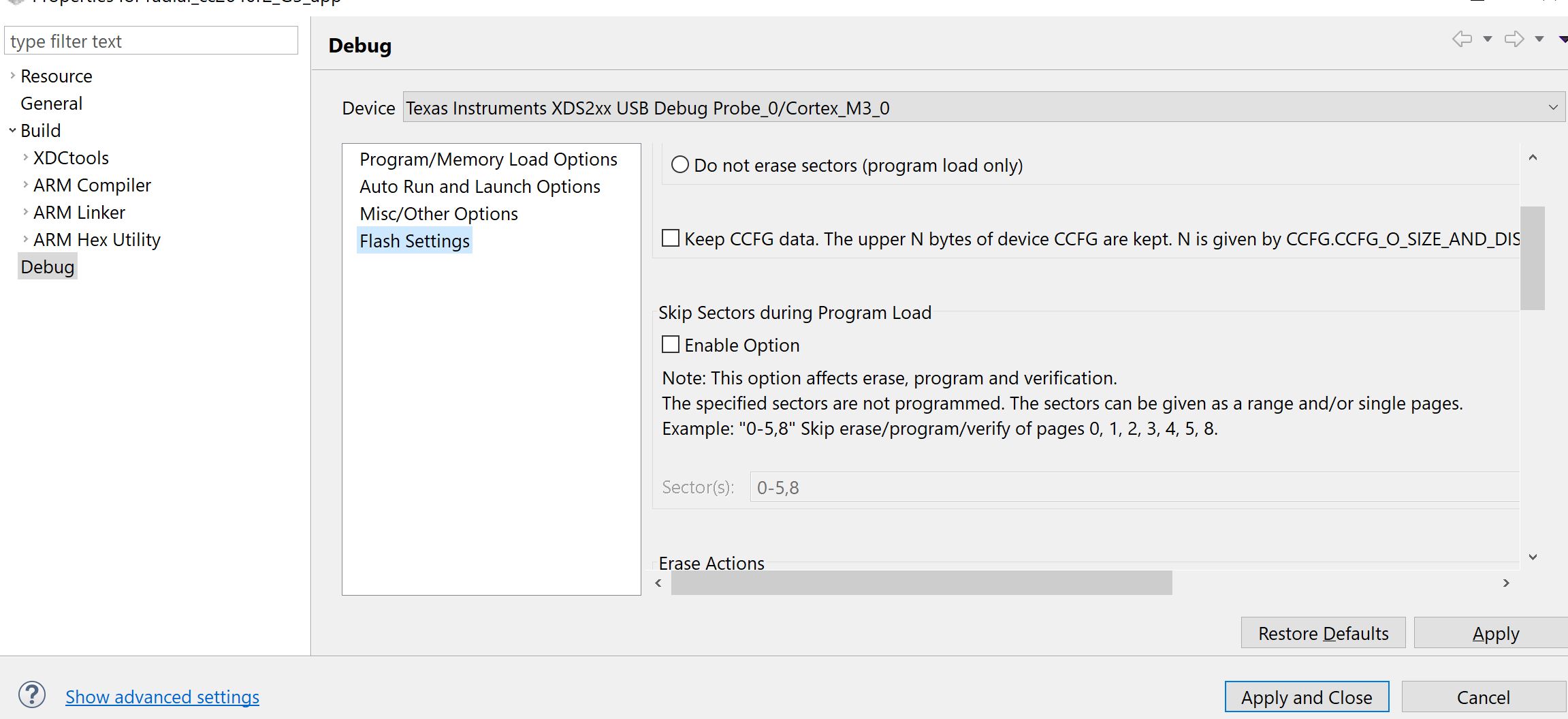

  • Hi Mitchell,
     After discussing this internally, there isn't a way to do that within the linker file. There is a NOLOAD type that it can be used, but it is not what your are looking:
    A NOLOAD section differs from a normal output section in one respect: the section's contents,
    relocation information, and line number information are not placed in the output module. The linker
    allocates space for the section, and it appears in the memory map listing
    For more information you can look in here http://processors.wiki.ti.com/index.php/Linker_Special_Section_Types or in the ARM Assembly Language Tools User's Guide.
    Also, they pointed out another way to prevent any flash programming from overwriting certain areas of the memory.
    In CCS, > Project Properties > Debug > Flash Settings, you can set what is written and what is excluded from being written during a program load.
      Hopefully this helps.

  • Hi David,
    Thanks for the help.  I have attached the dialog in CCS 8 defining flash areas to specify no-load Flash memory areas that you mentioned above.
    We are having a tough time mapping these "sector numbers" in this IDE dialog to flash memory addresses of the CC2640. We are using default memory configurations concerning stack and application space.  Perhaps this is an abstraction as CCS supports so many different TI processors and their memory maps.
    According to the TI CC2640 documentation, the flash memory spans from bus address 0x0000 0000 to 0x0001 FFFF where the SNV is 0x0001 D000 to 0x0001 E000.
    Question is what memory address does the "sector 0" of this IDE dialog start at in the CC2640 memory map?
    Also, how big is each "sector" in bytes? Is a "sector" is equivalent to a single 4096 byte flash page?
    Mitchell
