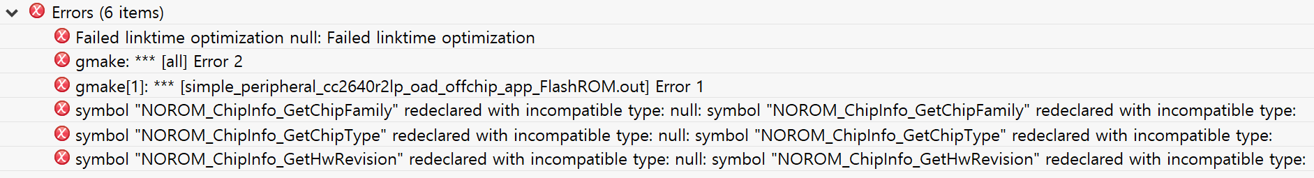

I want to transfer the voice data(pdm to pcm) input from the microphone to the smartphone application on the cc2640r2f board.
I looked at the link below.
dev.ti.com/.../voice.html
It seems that... I need to use the pdm driver. but there is no example code(CC2640R2F). So I tried to port the cc2650sensortag example code and refer to the BLE-Stack APIs (PDMCC26XX.h File Reference).
But there are some problems.. (I am using the SIMPLE PERIPERIAL OAD OFFCHIP example as a base)
I also changed including path. but...
Is there any refernce to pdm related cc2640r2f board? + Do I also need to change GAPPROFILE to send pdm data?
