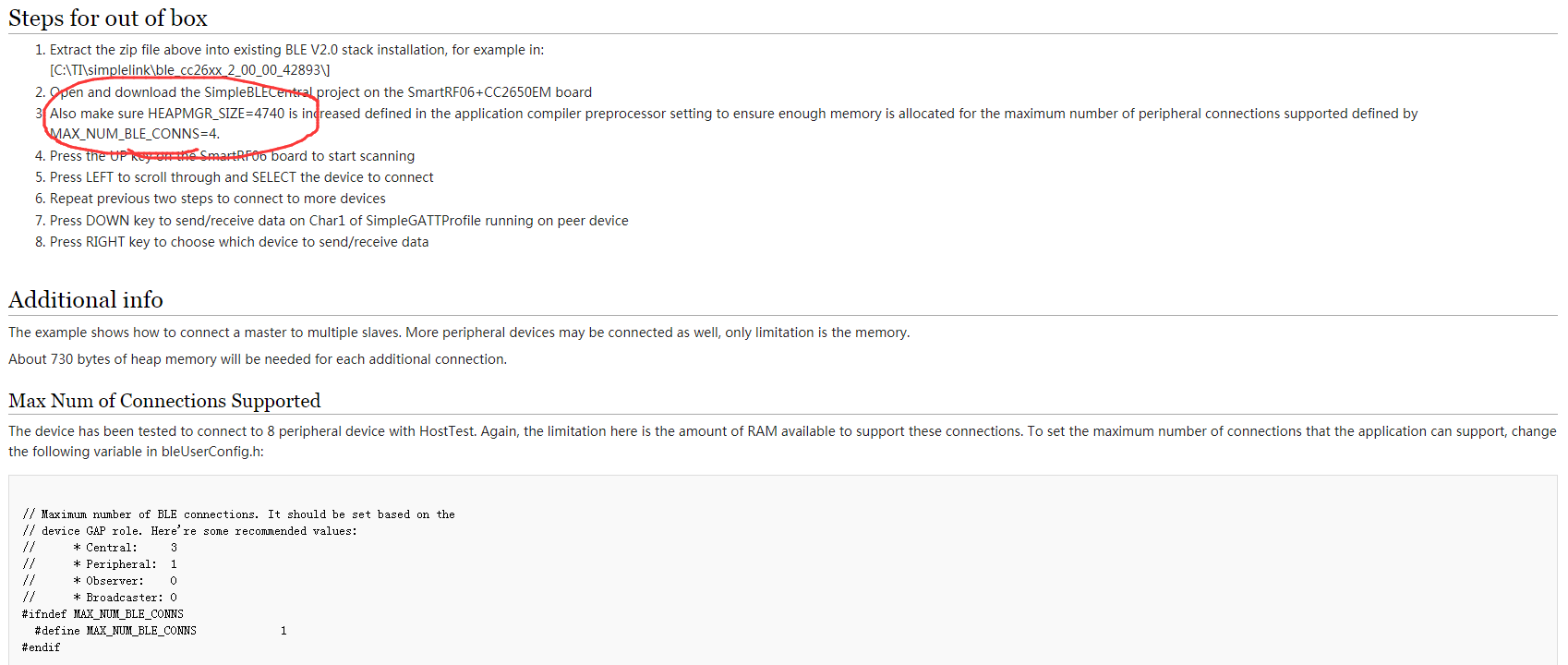

When debugging the CC2640R2F one master-multi slave function,using Simple_peripheral and Simple_central project,with default parameters,It can connect 2 slaves steadily.
When we want to connect a third slave, there will be time out and no connection.
The following configuration is re-compiled in the precompiler, but the result is that even the second connections will not connected.
The question is, why the second slave disconnected under my test condition?
How to modify the configuration correctly if need connect 3 or more slaves. Thanks!
