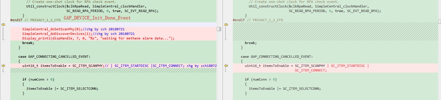

    change codes as below:
    1.comment the menu init
    2.add print function to scan results, and comment the add scan info function
    3.add function to the init event instead of key operation, enable only scan
    4.change scan parameters and comment "stop discoverying"
