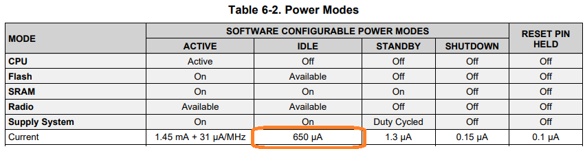

  • Hi TER,
    Thank you so much for the information.
    I am sorry for the confusion, the question was not about standby mode,
    it was about the Idle mode, as this Advisory is related to Idle mode.
    1.In idle mode the current consumption is 650uA as shown below.
    Does this Advisory mean +500uA increase to this Idle current consumption(60uA+500uA)?
    or does 650uA already includes this flash current?

  • Hi Paddu,
    The 650 uA current does not include the flash being on. For BLE use cases however, IDLE is typically used only when the radio is operating and you do not use the Cortex-M3. Unless your application code uses IDLE outside of this you will only get a 0.5 mA current increase for the period the radio is running.
    It is of course debatable if this errata really affects BLE at all though. BLE is designed to handle packet loss gracefully, so in the event this issue is triggered in your application it is not likely to give you any noticeable performance impact.
