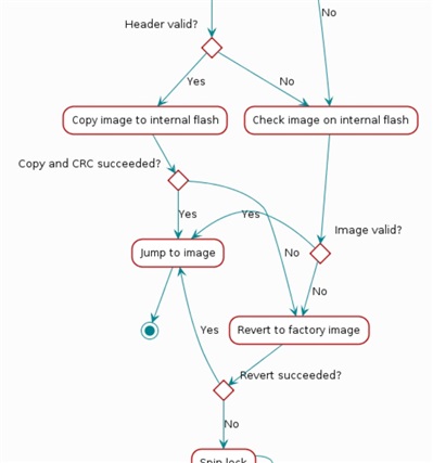

    I set the "CREATE_FACT_IMG_INT_TO_EXT_FLSH" Predefined Symbol at BIM and I am getting these errors and warnings below.
    Description Resource Path Location Type
    #20 identifier "intFlashPageSize" is undefined bim_main.c /bim_oad_offchip_cc2640r2lp_app/Application line 363 C/C++ Problem
    gmake: *** [Application/bim_main.obj] Error 1 bim_oad_offchip_cc2640r2lp_app C/C++ Problem
    gmake: Target 'all' not remade because of errors. bim_oad_offchip_cc2640r2lp_app C/C++ Problem
    #154-D conversion of nonzero integer to pointer bim_main.c /bim_oad_offchip_cc2640r2lp_app/Application line 352 C/C++ Problem
    #515-D a value of type "unsigned int" cannot be assigned to an entity of type "uint32_t *" bim_main.c /bim_oad_offchip_cc2640r2lp_app/Application line 352 C/C++ Problem
    <a href="processors.wiki.ti.com/.../225"> function "CRC32_calc" declared implicitly bim_main.c /bim_oad_offchip_cc2640r2lp_app/Application line 363 C/C++ Problem
    -kel
        I am reading the documentation for BIM for Off-Chip OAD. At the flowchart below to do Factory Reset I would just need to invalidate the image header of the application firmware at internal flash then I would do a system reset. Then it will "Revert to Factory Image". But, I do not see any code at the BIM for Off-Chip OAD to copy Factory Image stored at External Flash to Internal Flash. Is this really implemented or not?
    -kel
    With the build errors setting predefined symbol "CREATE_FACT_IMG_INT_TO_EXT_FLSH" and the flow chart not actually implemented. It seems that factory reset implementation at SDK is unfinished work. It is up to us to implement it.
    I will leave this post as unresolved since no one able to provide solution.
