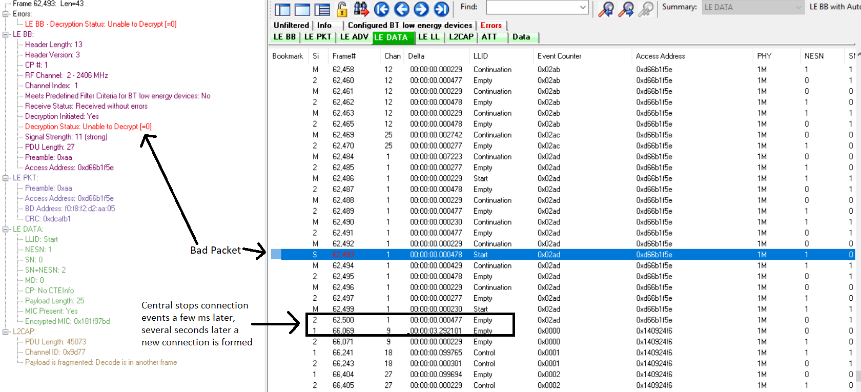

  • Josh,
    Which of the two sniffer logs that you sent show the event you showed in your picture? I'm having a hard time locating them or understanding your trace.
    These MIC issues can take a while to track down as an FYI. It's interesting that the slave starts transmitting data in the middle of a multi-packet CE. This may not be related, but I was hoping to see if there was a pattern of some sort to see if this happens each time you see a failure.
  • Hello Evan,
    Both of the *.cfa files I sent should have a captured a MIC error leading to a disconnection. The "Cap4_62493_TI_Central.cfa" file is the one I posted the screen shot of. Open it and go to the "LE Data tab, scroll down to "Frame #" 62493 and you should see the packet that caused the disconnection.
    In the Cap4_14818_UnableToDecrypt.cfa capture file, go to the "LE Data" tab, and scroll down to "Frame #" 14818 to see the corrupted packet.

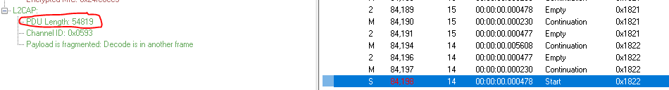

  • I've captured some more sniffer traces of the MIC issue and I've noticed something that's worth passing along. The L2CAP PDU Length field looks like it's corrupted in all of the offending packets. Here's an example:
    The sniffer is also flagging the packet as fragmented, I'm guessing this is caused by the bad PDU length, as our peripheral should never be sending a PDU that's large enough to require fragmentation. I captured 4 of these events, and the corrupted L2CAP header data seems to be random, I've seen lengths of: 54819, 9254, 10293, and 63539.
