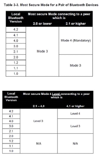

Dear Champs,
Customer ask us the NIST security mode and level on CC2640.
They provided below guide book from NIST
Which security mode and level do we support on CC2640 when used latest SDK v2.2.2?
If you have any suggestion, please feel free to let me know.

  • Dear Evan,
    As above NIST security guide book, we know its security mode and level as below classification:
    Does we CC2650 support mode 4 level 4 or more higher?
    If you have any suggestion, please feel free to let us know.
    Thanks a lot.
  • Hello Janet,
    The tables that you have cited in your post above from the NIST Special Publication 800-121 (Revision 2) are from section 3.1 covering BR/EDR devices. These tables are therefore not applicable to Low Energy (LE) devices.
    Given that the nature of your inquiry is for BLE, it may be better to directly refer to the Bluetooth specification where LE Security Modes are further explained. See 10.2 LE SECURITY MODES in BLUETOOTH SPECIFICATION Version 4.2 [Vol 3, Part C]:
    10.2.1 LE Security Mode 1
    LE security mode 1 has the following security levels:
    1. No security (No authentication and no encryption)
    2. Unauthenticated pairing with encryption
    3. Authenticated pairing with encryption
    4. Authenticated LE Secure Connections pairing with encryption
    Consistent with Evan's post above, the CC2640 with BLE-Stack 2.2.2 and CC2640R2F / CC2642R (all SDKs) support all the security levels defined by LE Security Mode 1. Although the specification defines a LE Security Mode 2 with "data signing", this is seldom, if ever, implemented.  Refer to the GAP Bond Manager (GAPBondMgr) documentation in the respective SDK's BLE Stack User's Guide on how to configure each level within LE Security Mode 1.
    Finally, the NIST pub does have the following in the Executive Summary:
    "For the low energy feature of Bluetooth (introduced in Version 4.0 and updated in 4.1 and 4.2), Security Mode 1 Level 4 is the strongest mode because it requires authenticated low energy Secure Connections pairing with Elliptic Curve Diffie-Hellman (ECDH) based encryption. Security Mode 1 Level 3 requires authenticated pairing and encryption but does not use ECDH-based cryptography and thus provides limited eavesdropping protection due to weak encryption. Other security modes/levels allow unauthenticated pairing (meaning no MITM protection is provided during cryptographic key establishment), and some do not require any security at all."
