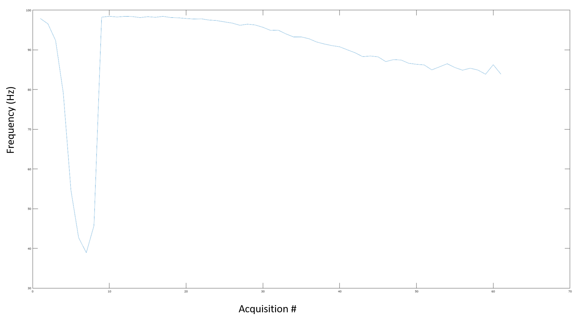

We are developing an acquisition system based on TI CC2650 connected to a smartphone through Bluetooth. As we need to track fast movement, we have recently modified the firmware of the sensor tag in order to boost the acquisition frequency up to 100 Hz.
However, we have observed that the acquisition frequency is not stable within the different acquisitions and sometimes the sensor tag acquire the accelerometer and gyroscope signal to a very low frequency rate. To isolate the issue we have modified the firmware in order to receive directly the timestamp used by the TI CC2650 and we have developed a mobile application to perform a stress test. This Android app allows us to perform a series of 60 consecutive acquisitions which are 1 minute in length (1 hour test session). We have tried with several TI CC2650 tags and different smartphones but every time we observe a worsening of the acquisition frequency which is followed by the rearrangement of the frequency to the 100 Hz nominal frequency. In the image below you can see the registered behavior and the observed valley in the acquisition frequency value.
Have you ever see something like this before? What could cause it? As this analysis has been performed using the TI CC2650 original timestamp, it seems not an issue related to the mobile application or smartphone.

  • The acquisition frequency is the frequency calculated on the basis of the timestamp of the sample acquired through the sensor. For the example above, the interval in ms between each accelerometer sample is used to calculate the average acquisition frequency within a one minute acquisition (our stress test protocol simulates several acquisition of 1 minutes however the same frequency issue can be observed with longer and nonconsecutive acquisitions in real life as well). The same behavior is observed if we use the gyroscope or barometer samples whose "acquisition frequency" is the same so it seems not a problem related to a specific sensor but to the whole platform.
    As the sensor parameters (i.e. SENSOR_DEFAULT_PERIOD) are set to 10 ms we are expecting that the average acquisition period is 10 ms. However this period sometime is bigger and thus the acquisition frequency (1/period) is smaller than 100 Hz. We are able to reproduce this behavior with different CC2650 sensor tags and different smartphones.
    It is not a problem of our application as we are using the timestamp generated by the sensor tag itself which is sent to our mobile application thanks to a FW modification of the sensortag. It seems a problem in the buffer management (if any) of the platform or in the communication protocol (because we don't know at which level the timestamp is generated by the sensortag!). By the way, the "acquisition frequency" is not always the same between different acquisitions (i.e. in 1 minutes at 100 Hz we are expecting to have 6000 samples from each sensor and instead sometimes the sensortag sends a smaller number of samples)

  • It seems to be an issue of the CC2650 (and other Texas platforms) in the I2C serial protocol that negatively affects the performance at high frequency. We are trying to debug it since Texas is not able to provide a work-around or fix for it.

    Since we both are comming to this thread for the first time, I would describe to you what I've done so far:
    I'm currently working with the CC2650 SensorTag (and its DevKit) in Code Composer Studio 8.2.0 and the BLE SDK 2_02_02_25.
    I'm using the sensortag_cc2650 project with some modifications.
    What I'm trying to do is acquire data from the Movement Sensor (MPU9250) at 100Hz.
    To achieve this I modified the following sections of the firmware, setting them to 10ms:
    In st_util.h, SENSOR_MIN_UPDATE_PERIOD
    In sensortag_mov.c, SENSOR_DEFAULT_PERIOD
    Moreover, I'm using the timestamp module within the sensortag_mov.c to get a timestamp in milliseconds from the board.
    I increased the MOVEMENT_DATA_LEN by two bytes (originally this was supposed to be four, but with four it becomes very problemmatic) and I'm assigning the timestamp into the last four bytes of the data characteristic.
    As Simone mentioned we have developed an app that allows us to perform a series of 60 consecutive acquisitions, of 1 minute each.
    We consider an acquisition to be the data we receive from the texas between START/STOP commands.
    Since each acquisition has a duration of 1 minute we expect to have ~6000 samples in each of them.
    The number of samples is our first approximation into determining the acquisition frequency, but since we also have the individual timestamps we use the mean time difference between successive timestamps as an indicator of the acquisition period and acquisition frequency.
    I have isolated the problem to I2C as a suggestion from a TI-Employee in another thread.
    Moreover I've used the CC2540 USB Dongle and the PacketSniffer and by manually correlating each packet to the data acquired I was able to see that I'm not loosing  any data during the transmission.
    I don't have the equipment to capture the I2C trace, so I haven't been able to go further.
    Please let me now if the FW or the stress test .APK would be useful for you.
