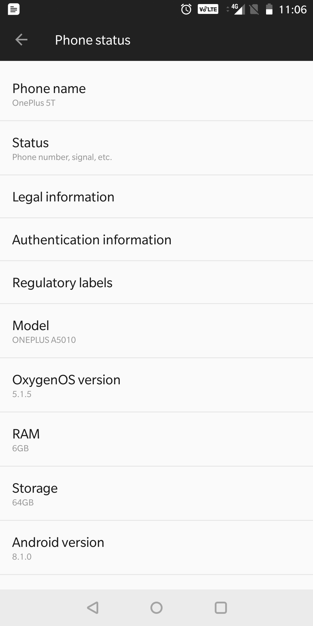

I am using CC2640R2F for my development. I am using simplelink_cc2640r2_sdk_1_40_00_45 SDK for my development.
I observed this device is not getting listed when scanned by oneplus mobile. It gets connected with other mobiles.
I tried installing nRF connect app on oneplus but it is not listed even with nRF too.
Is this known issue? Any workaround available for this?

  • Hi Jessica Heider,
    Thanks for your response.
    I am using 8.1.0 version of android. I have tested with both the apps, but still the device not getting listed during scan.
    Please find screenshot of Android version.
    Lakshmikanth
