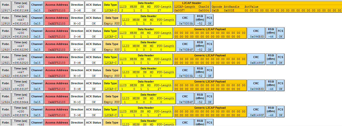

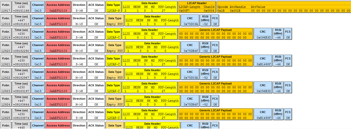

    If you can take a sniffer cpature of this I think it could help us understand why there is so little data being transmitted. E.g. see what the connection interval is, how many packes per connection event etc.
    If the problem is that the master device only accepts a few packets per connection event, you can try to send a connection parameter update request from the CC2640R2 device to get a shorter connection interval.
    Does the Xiaomi Mi4i device support Data Length Extensions (DLE, Bluetooth 4.2 feature)?
    With a smart phone as the master device I would not expect to get close to 800 kbps. I have not tested with Xiaomi, but with other android devices (that support DLE) I have seen 500-600 kbps.

    I used a sniffer but I didn’t realize anything more.
    I changed MUX_NUM_PDU to 254 and MUX_PDU_SIZE to 248 in ble_user_config.h and in mobile app I can get 244 bytes. So I think that Xiaomi Mi4i supports Data Length Extension. However it’s Bluetooth version is 4.1 not 4.2 . Is it reasonable?

    Based on your sniffer log, the devices are already sending multiple packets per connection event. (See the timing between packets, which is on us level, and see the channel number for each packet. In the BLE protocol, the channel is changed for every connection event.)
    On the other hand, your sniffer capture screen shot does not show how long the connection interval is. Can you look at how long time passes between two packets on different channels to see how long the connection interval is?
    Your Xiomi Mi4i does not support data length extensions. From the sniffer log you can see that each packet contains 27 bytes of payload. Your PDU can still be large (255 bytes), but the BLE-Stack fragments it into smaller units that go over the air (MTU). This is called L2CAP fragementation and you can read more about it here: dev.ti.com/.../l2cap.html
    The project we used to demonstrate BLE throughput is found here on github: github.com/.../simplelink_sdk-1.40 . However it is based on the Bluetooth 5 stack so I do not know how useful you will find it.
