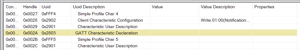

Part Number: LAUNCHXL-CC2640R2
Hi there,
I am working on CC2640R2 launchpad with SDK 1.50.0.58 simple_central_cc2640r2lp_app.
I am trying to find CCCD of CHAR5(UUID FFF5). CHAR4(UUID FFF4).

3. the weird result is that the ble stack still send a read request with UUID of CHAR1(0xFFF1), what I expect is send a read request with UUID of CCCD(0x2902)
here I attached sniffer result:
you can see that:
#870 is sample code send a read request with UUID 0xfff1
#878 is slave response
#885 is my code to send a read request with UUID(should be 0x2902), but it send a request with same UUID of 0xfff1

      Are you also using simple_peripheral? Because CHAR5 (OoB) does not have a characteristic configuration (GATT_CLIENT_CHAR_CFG_UUID).

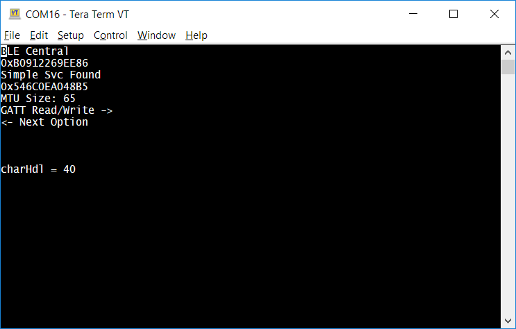

    I got the correct handle (0x28), please see below:
     Could you please try with the OoB examples and let me know if you see the same behavior.

    1. and yes, I can get 0x28 if I modify code (right on the original code, replace CCCD UUID). This is right.
