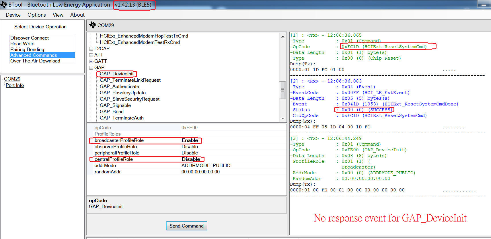

    2. BROADCASTER_CFG can't work properly?
    2-1. Change to -DHOST_CONFIG=BROADCASTER_CFG then re-build by CCS
    2-2. Using BTool to execute the following commands.
    a). GAP_DeviceInit(0xFE00)
    broadcasterProfileRole: Enable
    centralProfileRole: Disable
    Test Resule: No any response event
  • Hi KunLin,
    With the holidays in season, I am not going to have any time to reproduce your issues. Have you spent any time looking at enabling what your trying to enable in the code? I know all this is feasible in the code and am just curious.
    You can reference how the code calls each GAP/GAPAdv/GAPxyz API and re-emulate in BTool ensuring that you have the right host config enabled.
    Also make sure that after you change your host config, that you recompile both stack and application and re-flash.
