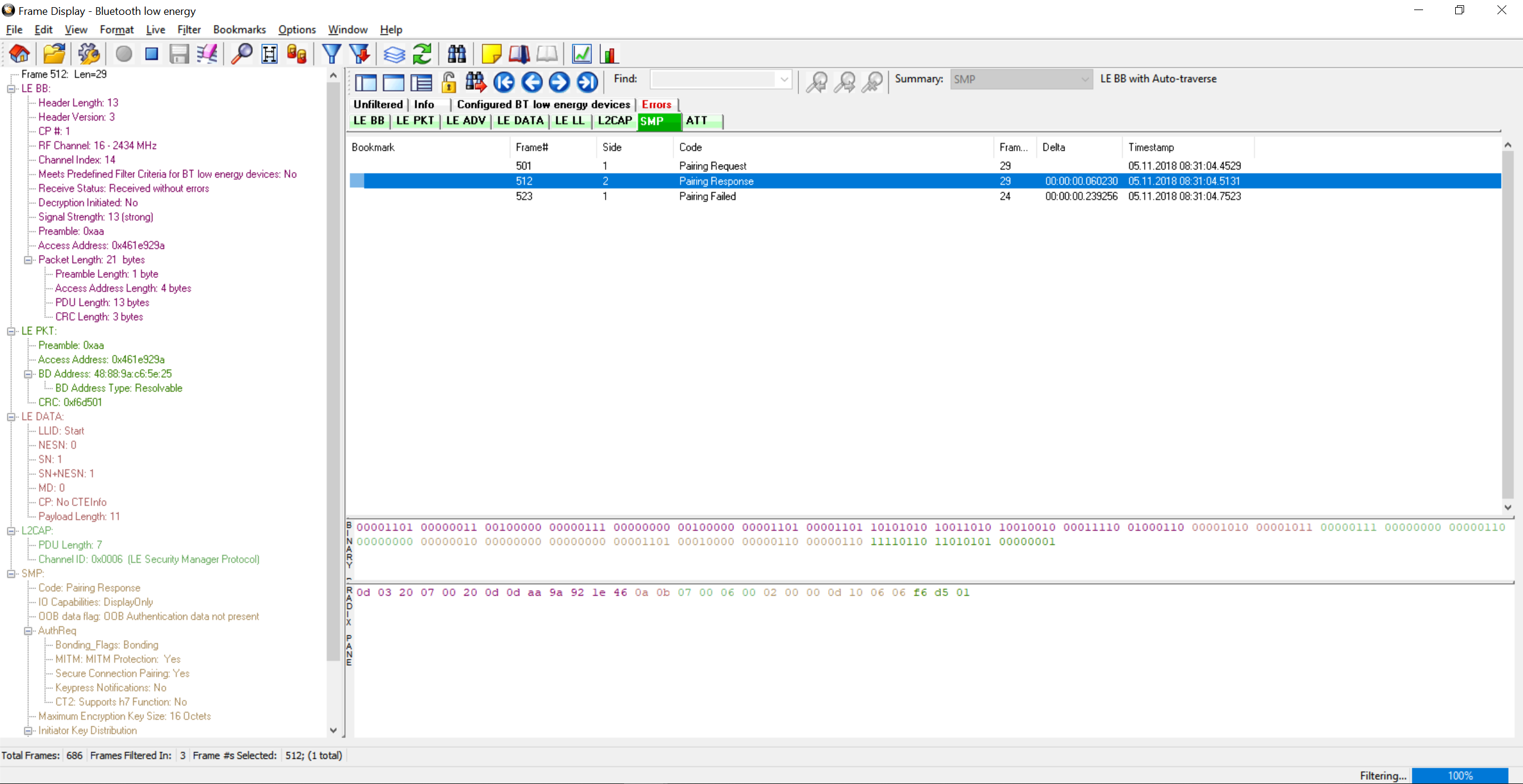

I took the CC26x2 SDK 2.30.00.34 and compiled the example “simple_peripheral” (FlashROM_Release) with IAR Workbench 8.22.2.15996 and used it together with Launchpad CC2652R1 (according to sticker Rev 1.0.1).
The example firmware is up and running and shows correct messages on serial console.

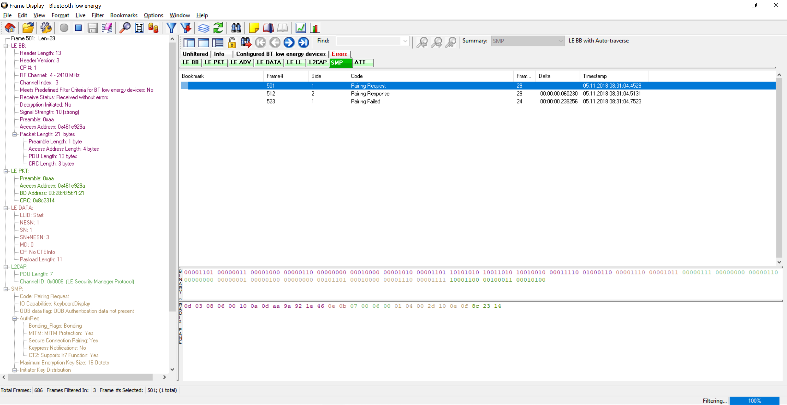

The advertisement works fine (see Frontline capture) and Windows 10 (version 1803) finds the simple_peripheral and connects to it, but pairing fails all the time and therefore connection will be terminated immediately.
The SMP error is “Pairing Failed”, “Invalid Parameters” (see attached screenshots and Frontline capture).
Any feedback is welcome.
Regards............tobias
Frontline Capture File: https://www.zeta-uploader.com/2059676674

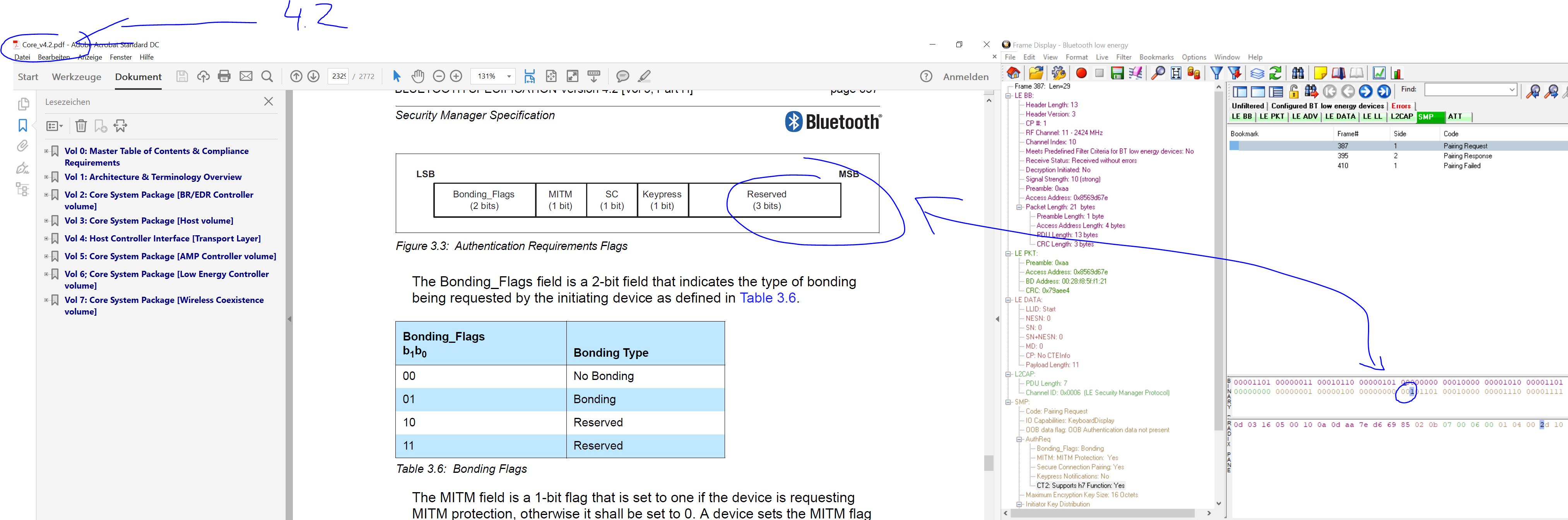

    ...and I made two observations:
    Windows sets the AuthReq CT2 h7 support bit (pls see attached picture). Could this lead into problems?

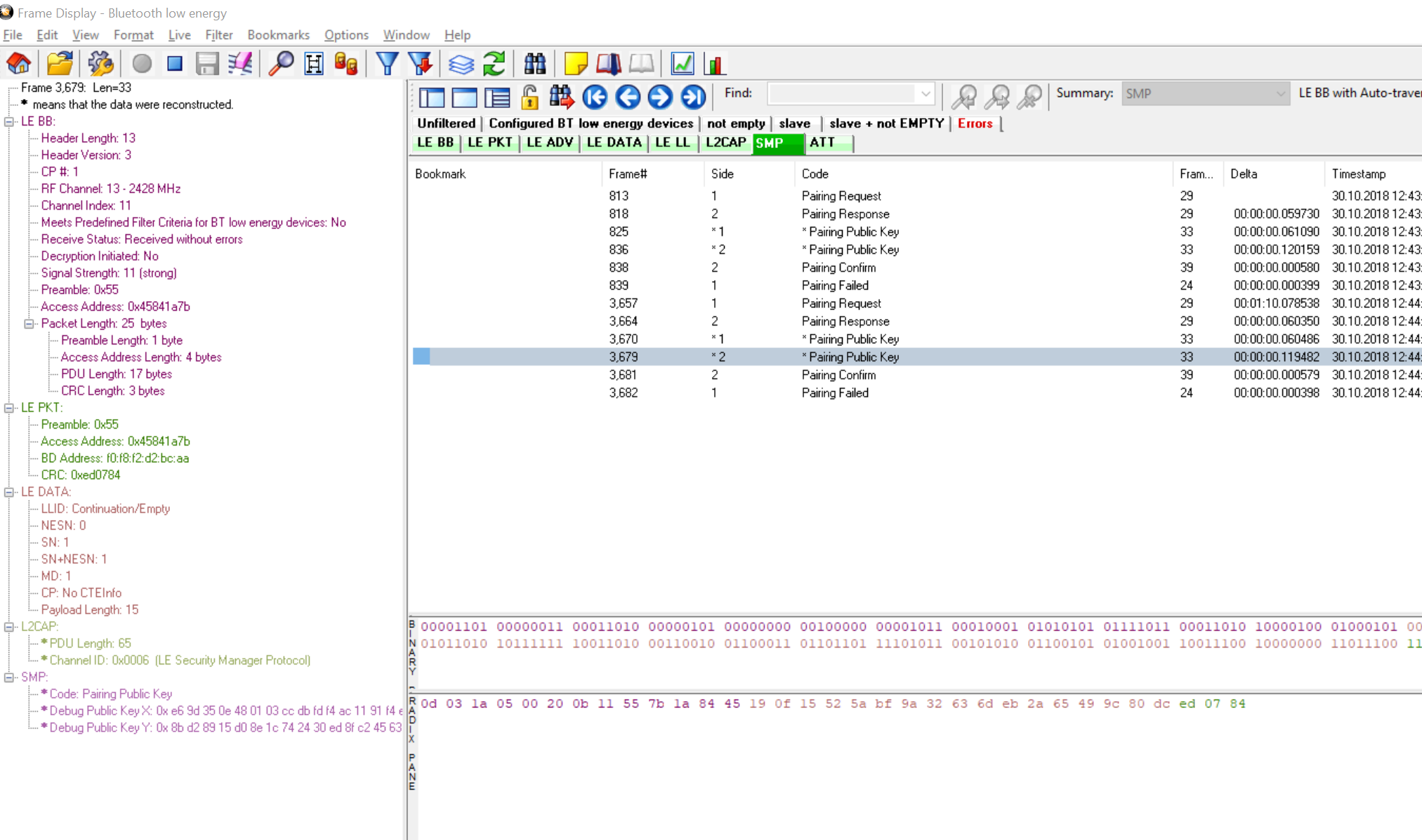

    And when pairing fails, CC2652R 's reply contained the Public Pairing Debug Keys.
    The Frontline capture doesn't show the pairing key exchange because DLE can be active at that point and Frontline BPA can't capture DLE. But somtimes - depending on when DLE is activated - the pairing keys are exchanged with link layer fragmented packets which could be captured and decoded. And to be 100% sure we captured with an Ellisys Bluetooth Tracker with DLE support, too :)
    So I can say for sure that the Pairing Public Keys are exchanged always right before the master replies with "Pairing Failed", "Invalid Parameters" (although my previous Frontline file doesn't show the pairing key exchange).
    What do you think, could it be that the master replies with "Pairing Failed" because the CC2652R is sending the Public Pairing Debug Keys?

    Can you send us your Ellisys files? As explained in our BLE5-Stack User's Guide, the device uses a Public Pairing Debug Key so you can decipher over-the-air sniffer logs with LE Secure Connections enabled so that should not be the cause. The AuthReq CT2 bit is new for BLE5 which is why it was reserved in the BLE4.2 Core Spec. We have been able to pair with other devices that set CT2 but we can look into this further with the Ellisys logs. I would like to point out that we can give general support on this, but I would recommend also contacting Microsoft with this issue in case they have had similar issues with their BLE stack.
