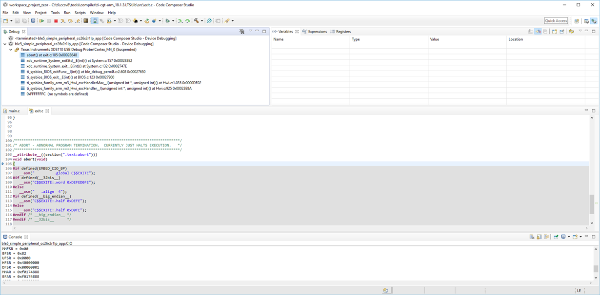

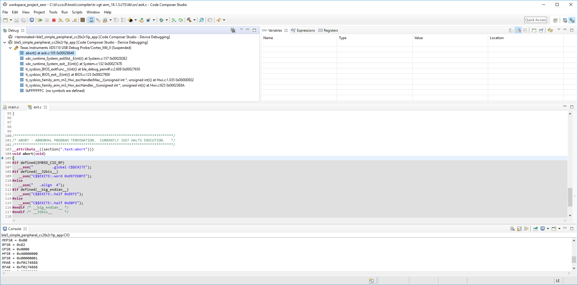

    Test 1: 4 iOS devices (of which one with BLE5 support, we see the PHY speed change to 2M)
    Run 1:
    After 3 minutes, the Ti2642 got into an abort. This was actually something we didn’t see before.
    Note: The app will connect to the device advertising with SimplePeripheral and some specific service. Sometimes the iOS app doesn’t connect anymore, then kill it and start it again.

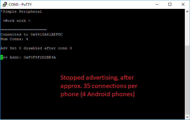

    Test 2: 4 Android devices (with three parameter updates per connection)
    Using the test app, after approx. 5 minutes (per phone 35 connections/disconnections):
    • The Ti2642 stopped advertising.
    • All devices lost connection, but the SimplePeripheral app seems to be stuck: it doesn’t show any phone disconnecting.
