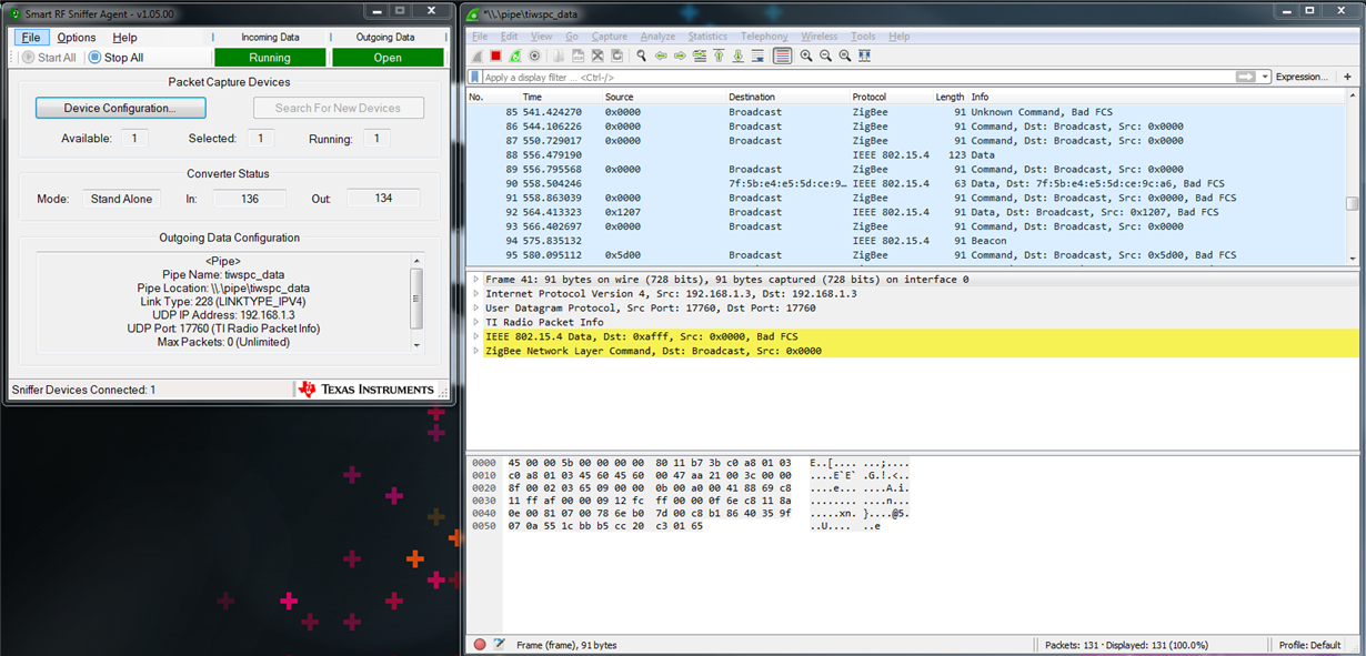

  • Hi Christin,
    Reading the Smart RF Sniffer user guide, I was able to locate the sniffer firmware image for a LAUNCHXL-CC2650 board and get the Smart RF Sniffer and WireShark tools running. However, I need some help configuring the tools to show the packets being transmitted from iOS to my device. I am currently using the default configuration of "Ch 11 - 2405.0 MHz". Attached is a screen capture of the data I am capturing. It does not look like any of the data transmissions from iOS is showing up.
    Jeffrey
    The sniffer for CC2650 is for 15.4, so it does not deal with BLE packets.
    We will have BLE sniffer for CC2652 and CC1352 in our coming SDK release. Target mid-Jan. Till then the only available BLE sniffer we have is the dongle as I posted earlier.
