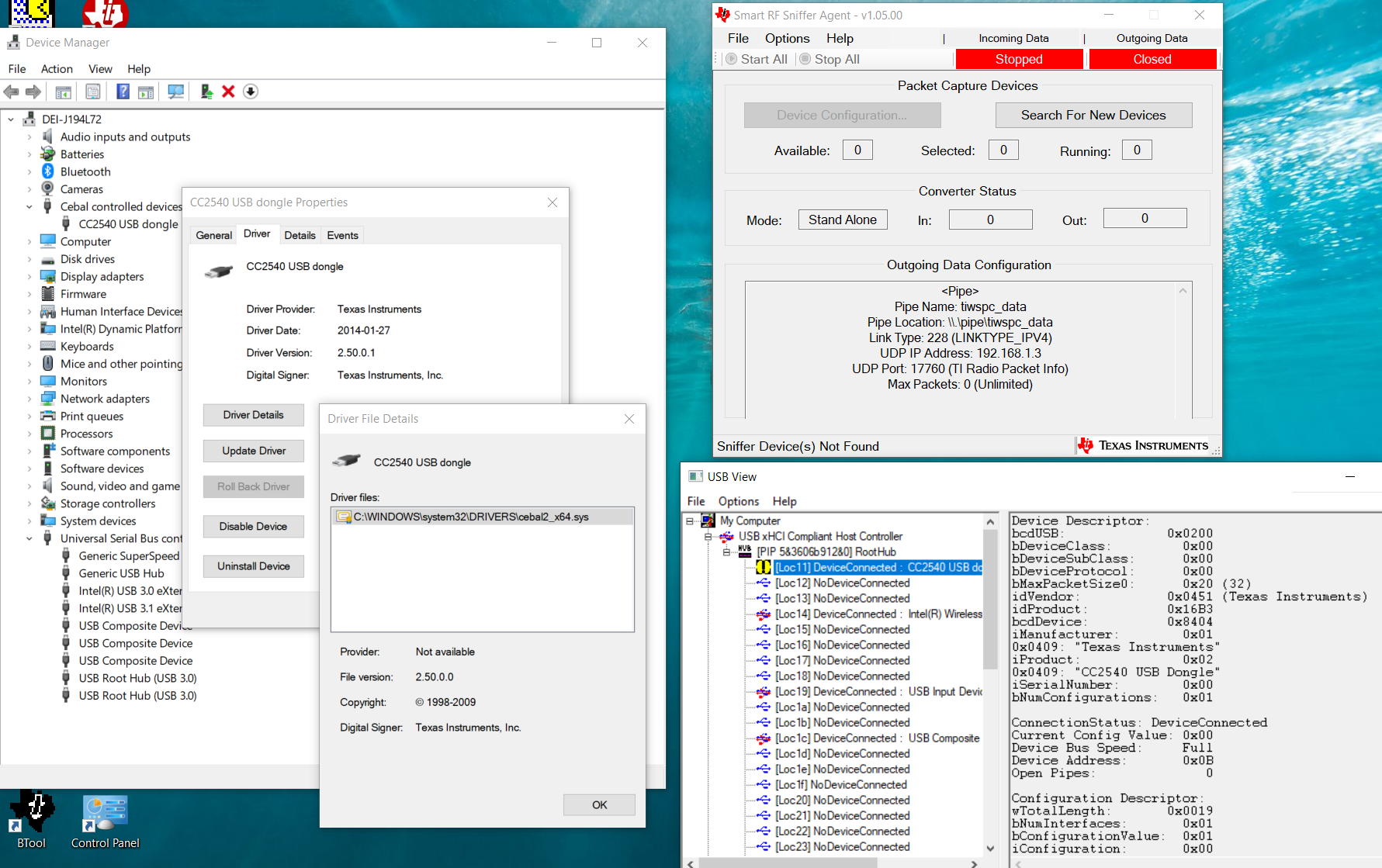

CC2540: Smart RF Sniffer agent odes not see CC2540 USB dongle
Part Number: CC2540
The Smart RF snifffer agent does not see the CC2540 USB dongle inserted. In the Device Manager, the Cebal driver is listed.  I installed the SmartRF_Packet_Sniffer2_1.5.0 and smartrftm_studio-2.11.0. I have a USBview utility I downloaded from FTDIchip and it gives a yellow black icon that I don't usually see. What do I do next?
Frank
Device Descriptor:
bcdUSB: 0x0200
bDeviceClass: 0x00
bDeviceSubClass: 0x00
bDeviceProtocol: 0x00
bMaxPacketSize0: 0x20 (32)
idVendor: 0x0451 (Texas Instruments)
idProduct: 0x16B3
bcdDevice: 0x8404
iManufacturer: 0x01
0x0409: "Texas Instruments"
iProduct: 0x02
0x0409: "CC2540 USB Dongle"
iSerialNumber: 0x00
bNumConfigurations: 0x01
ConnectionStatus: DeviceConnected
Current Config Value: 0x00
Device Bus Speed: Full
Device Address: 0x0E
Open Pipes: 0
Configuration Descriptor:
wTotalLength: 0x0019
bNumInterfaces: 0x01
bConfigurationValue: 0x01
iConfiguration: 0x00
bmAttributes: 0x80 (Bus Powered )
MaxPower: 0x32 (100 Ma)
Interface Descriptor:
bInterfaceNumber: 0x00
bAlternateSetting: 0x00
bNumEndpoints: 0x01
bInterfaceClass: 0xFF
bInterfaceSubClass: 0xFF
bInterfaceProtocol: 0xFF
iInterface: 0x00
Endpoint Descriptor:
bEndpointAddress: 0x83 IN
Transfer Type: Bulk
wMaxPacketSize: 0x0040 (64)
bInterval: 0x05
