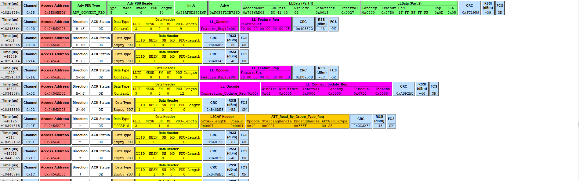

    Attaching the sniffer capture.
    Here in this capture, no response is received for "ATT_Read_By_Group_Type_Req".
    Finally master issues a "LL_Terminate_Ind".
    The device stops advertising after this and functions only after a hard reset.

  • Hi. Can you attach the complete capture (the file) instead of a screenshot?
  • Ok thanks. Unfortunately, the sniffer doesn't tell us much. The heap does look fine.
    I think the next step is to see how the GAPRole is getting into GAPROLE_WAITING. I would try logging each event and status when gapRole_processGAPMsg() is called.
